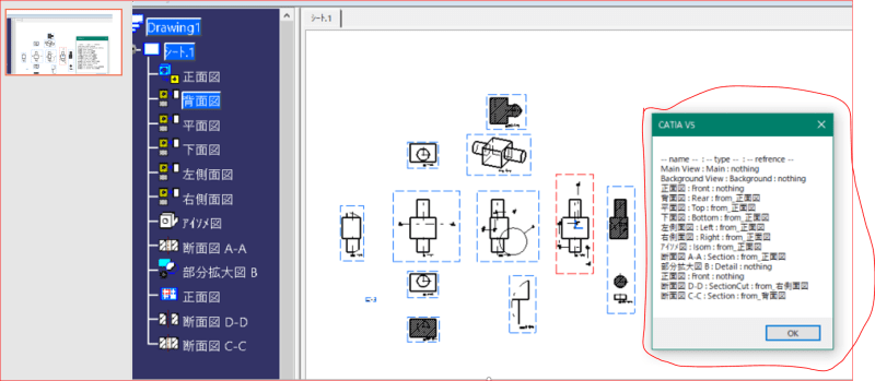

Hi All,
Can I identify the Main view from which section or Auxiliary or Detail view are taken through VBA. Please help me to solve this.

I may have misunderstood the meaning of the question.
I made a sample code and tested it.

When CatDrawingViewType.catViewDetail,Acquisition of ReferenceView fails.
In addition, there were times when CatDrawingViewType.catViewSection / catViewSection failed.
I made a mistake.
DrawingView.GenerativeBehavior.ParentView
I should have confirmed.

I do not get it yet.....
How did you get the window marked in red (see the picture below).
Have you used the MB3?
Did you click on the view in the tree?
Can you place a step-by-step direction, please?
I want to learn this.....

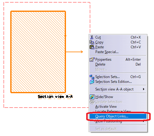

Is there another way to access ReferenceView Property, other than using a macro?
CAD 2015
I think there is no way to check multiple ReferenceView & ParentView other than macros.
If it is one, you can check this in the context menu of any view.
