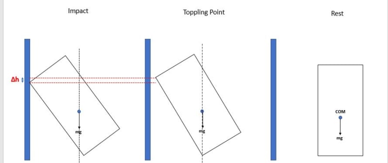

I want to calculate the impact energy of a toppling cuboid striking a vertical surface.
Once the cuboid is brought just past it's toppling point the only force acting will be it's weight.
Will the energy of the impact be equal to the transfer of gravitational potential energy to kinetic energy if we assume no energy is lost due to heat or sound? i.e. Will the transferred to the surface simply be mg∆h?

*Correction
∆h should be the difference in heights of the COM (not the corner as shown in the picture)

Neglecting energy losses, it will bounce right back up on that far corner then rock back and forth.
Don't forget rotational energy.

Thanks, thinking about the moment of inertia is why I've simplified it as a cuboid.
In reality it's frame assembly with many members, so it got me thinking would i even need to consider inertia before spending the time figuring it out.
I will look further into rotational energy.

The "impact energy" is simply the change in potential energy of the object. The usefulness of this number is very doubtful, however. Impacts are complex events, and have been discussed in many threads here, usually with no clear answer. What is it that you really want to ultimately figure out?
Mostly your approach (mgh=linear kinetic energy=(1/2)mv^2 converted to rotational kinetic energy = (1/2)Iω^2) is correct if you want preliminary calculation for the amount of energy absorbed by the cuboid while free falling. But It has some limitation like it does not consider the rebound plus energy lost in friction between the surface and cuboid.

I have modelled the system as an inverted pendulum and assumed that all of the rotational energy was transferred into the cylinder at the point of impact, neglecting the initial angular velocity which caused the bundle to topple in the first place.
I'd say PE is converted to rotational KE. You're assuming a rigid contact surface (zero coefficient of restitution, no bounce; no strain energy absorbed by the surface).
