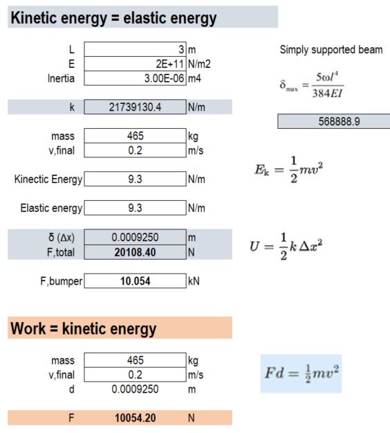

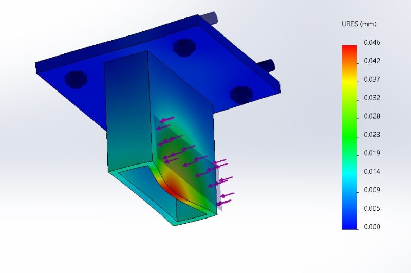

Trying to estimate some other approach for the reactions on the stiffest part of the frame, I modeled a type of support for the steel profile.
With a load of 1KN e got a total deflection of 0.046 mm that translates on a stiffness of 2.17*10^7 N/m (wich is really rigid).
With that I got a reaction of 10 kN, wich seems kind of high.
Any toughts about this results?

I think modeling the entire jamb and all the contact points would be more realistic. Modelling the stiffest contact point and extrapolating that result as the overall jamb “spring” is likely overestimating the global stiffness of the jamb.

GoncaloPT - It's great that you are looking at this problem using different methods. Hopefully you will see some convergence in results, but you have to keep the boundary conditions consistent between the various methods. For example, you previously used the deflection formula of a simply supported beam under uniform loading to obtain jamb stiffness. But the FEM is more akin to a short cantilever with a point load. If you can bring the boundary conditions of those two methods into alignment, I think you will see the results converge.
