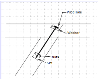

Inclined screws in wood under tension
PROFR
Feb 28, 2019
33
I am trying to connect two LVL beams as shown below in which one of them will be under tension. I am using inclined lag screws. I checked the tension capacity of the screw embedded in member (b) considering the end grain condition and it is OK. I am not sure how to check the screw capacity in member (a). It there any check needed here?

knife plate connection?
gussets on the sides?
screws alone not appropriate here, IMO

retired13,
The technics link is a wood screw thru end grain (first piece) into cross grain (second piece). Essentially reversing the original question and arriving at BAretired's solution.

I know a lot of folks here have voiced concerns about getting screws or nails to hold in end-grain. That's certainly something to consider, but that's more of a problem with wood screws, nails, sawn lumber, and thin lumber. That concern might have been overstated for this particular application.
LVLs dont split in the same way that sawn lumber does. Lag screws have larger threads that take more splitting to disengage the threads. Lag screws should be pre-drilled to reduce splitting.
I think we can all agree it's a bad idea to sink four 1/2" diameter lag screws into the end of a 3x6 sawn member, but Four 3/8" lag screws into the end of an LVL 3.5x9.25? That shouldn't be a problem.
