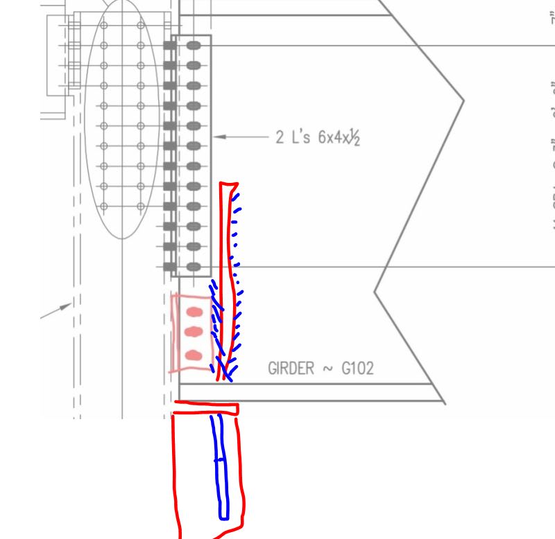

Hello all,
I have an existing girder that is getting an increased load. After analyzing the existing shear connection, I have found it to be 60k short (about 13% too low). I am wondering if there are any implications to adding another shear tab or double angle connection below the existing connection to take the additional 60k.
My gut is that adding another 3 rows of long slotted horizontal bolts in a double angle connection would work well. I think that rotation compatibility would still be okay since we are not engaging the flanges of the girder and there would be long slotted horizontal holes in the angles.
What are your thoughts?
Your strategy could work out just fine.
Depending on the governing limit-states and field-conditions, you might have alternate solutions available. For example: strengthening the conx by applying a pair of C-shaped field welds at the angle legs to the girder and abandoning the bolts in place.
I like your proposal and expect that most engineers would do the same.
That said, I do have some concern for load sharing:
1) The existing connection would need to deform a fair bit before fully engaging the lower connection I feel. Bolts are pretty good at redistribution though. And, really, this situation is pretty similar to what happens often with vertical bracing connections.
2) At the connections to the column, I'd not want to mix bolts and welds for fear that they would not deform compatibly and the welds would rupture. If possible, I would seek to use bolts for both conditions.
My Cadillac solution here would probably be a new bearing seat capable of handling all of the load on it own. That would be a heck of a seat though and may well intrude spatially in a way that would be non-starter. Beam stiffener install might be tough too.
Thank you for your input. Using bolts on the column side make sense too. I'll probably add an extra row of bolts to be safe.

What is the governing the failure mode currently? This may impact the strengthening chosen. And how much locked in load would the existing component be taking at the time you strengthen the connection? If theres only small locked in load then you won't have that many issues with load sharing between additional components.
You could investigate whether welding all around the L plates to both sides of the beam web would give you sufficient capacity, and design the weld to take the full load. Just need to be mindful if the connection is highly stressed in its current state if there are implications from heating it. If you are just supporting self weight of the beam for example, this is not usually an issue, but if you have got a fully loaded beam this might not be the best option.
I like DrZoidberWoop's suggestion. Weld the existing double angle connection to both the girder and column and design the welds to take the full load. If that doesn't give you enough strength, then add the additional angles per HDStructural's illustration (using welds). Leave the bolts in place, but don't rely on them for any strength.

I'm not convinced ADD-A-BOLT will take proportional load
I agree with you that adding one bolt, especially near its fully loaded state won't necessarily fix the problem. However, 80% of the load on this connection is a live load, so when the additional bolts (need 3 more rows, but will add 4 rows) are added only 20% of the total load will be applied. The remaining live load should adequately distribute to all of the bolts.
This would be a good solution but unfortunately the angles only have a little more capacity in them. So more angles will be required.
