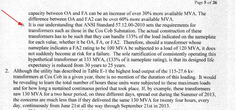

I found this:
It seems like North American standards require a 133% safety factor?

@PRC- interesting perspective! Can IEC units tolerate a 133% overload for all ratings for several hours with a slight life reduction only?
