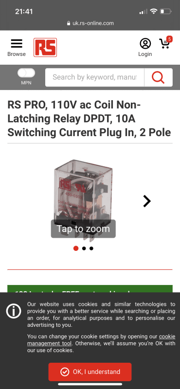

I have a question on inductors I’m trying to get my head round. I have a rough understanding how they work as the current through the coil produces a magnetic field and it’s the back EMF that limits the current through the inductor. I also understand with motors when you get a locked rotor the current draw goes up due to the back EMF not limiting the current. But my question is when it’s just an inductor such as a relay coil can these ever cause a similar overload to what we’d get with an induction motor when it has locked rotor?
The reason why I ask is I have seen relay contacts with the current of the contacts stated a 3amp inductive and 8amp resistive which then again got me thinking as the relay was bringing on one relay but is only being backed up by a 6amp fuse so my thinking was if it could overload the contacts would melt before the fuse?
Thanks for your help in advance guys!
This is me being naive now but how can you tell how much current a relay contact will be taking say for example this relay coil was being switched on by a relay contact rated for 3 amps
Check the spec sheet.
What I find: "Coil Power 1.2 VA"
1.2 VA at 110 Volts x 1000 = 10.9mA
Inrush limited by coil resistance of 3830 Ohms to less than 28.7 mA.

Contacts are rated according to VA product for breaking power because the motor contact opening instantly becomes a generator and that power turns in an arc burning the air between the contacts at over 5000'K. With AC the next current zero crossing might extinguish the flash, but with DC , it is sustained with a force proportional to current. Thus the gap of the contacts for DC determines the threshold for DC power that can be extinguished, and for reliability you want to be well below that curve.
An AC Relay when used with DC must use a flyback diode. For AC an RC Snubber is a good choice somewhat looks like a plastic Run cap, but with an embedded series R.
e.g. 6A "AC relay" rated for 1200 VA ac can only handle about 300 Watts DC Resistive breaking current.
