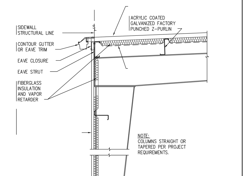

Below is your classic low end pre-eng building envelope. This is snipped from a current website of an IAS certified supplier. This does not perform well in many climates, and few owners think much about in my experience. In Canada, this should not be built in most municipalities due to the energy code, but we see it frequently. That said, we see tons of architects that want all their custom steel to fit nicely in the exterior wall as well. I don't fault the PEMB suppliers at all for any of that. Buyers need to be aware and look thru the brochures with something other than cost in mind. I think the PEMB is a great solution, but you need to know the options and evaluate them carefully.

When you say it does not "perform well", in what sense do you say that? It is poor structural, energy or some other desired trait?

Ron, the problems we have had with the low end building envelope are all non-structural. We have worked with quite a few pre-eng suppliers and even the smaller companies have all produced a fine structure. I get involved in the renovation aspect, so that is where I see some of the headaches down the road. Some of the issues with the roof/wall envelope are:
1. Roof insulation is heavily compressed at each roof purlin. This can cause snow to melt at these points and and this can start icing problems. I have pictures of this type of roof with 24" or so of ice at the eave.
2. The exposed fasteners have a rubber grommet to form the seal. That hardens over the years, and we have found instances of leaks at these locations. I am sure the grommet quality has improved over the years. We generally steer our clients to a better roof and wall system.
3. The icing problem usually leads to a gutter failure. Many in sales have suggested ice rakes, but those typically fail as well.
4. This roof and wall envelope does not meet many current energy standards.
Keep in mind I generally work in a cold climate, so some of my notes will not apply to many.
The items you are pointing out are typical for low or high end PEMB companies. It seems more like every PEMBs "Low-end" offering has the same problems. I am in the sunbelt so I have to turn on a TV to see snow. Problem is that some low-end suppliers do not have the higher end roof and wall panel offerings, so for a low-end supplier there are no alternatives to cure your problems.
