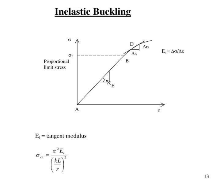

I think you can find many articles about inelastic buckling. Here explains by a stress-strain curve.
Inelastic buckling is due in part to a loss of stiffness associated with the the progressive yielding of the cross section as you increase the load. Residual stresses impact on this progressive yielding causing some regions of the cross section yielding before others. Simplistically flange tips of I section start to yield first for example, resulting in stiffness reducing which impacts on the stability and buckling occurs prior to the theoretical elastic buckling load being reached.
The intermediate column tends to buckle inelastically. Please have a look on the linked PPT (p.11). Link
