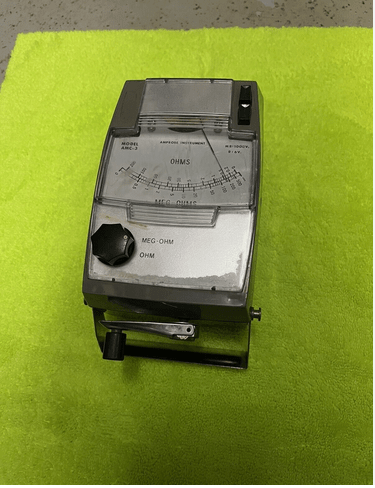

We meggered motor 1 and it came in around 500 megs on all phases. We meggered again including the cables from the output contactor down to the motor and got the same. Phase to phase measurements were all similar, around 0.6 ohms DC resistance, but the meter used is not very accurate at that low of a reading. This is a fluke 287, and I don't think it's accurate to 0.1 ohms at that load. The calculated impedance of the motor windings, operating at pf of 0.84, results in a per winding impedance of 0.492/_32. Therefore I believe the fluke readings are reasonably valid.

You may not always be able to trust a megger reading on AC.
We had a cable that passed an Ohms test and a 250 Volt megger test but was a dead short to ground on 120 VAC.
Meggering at 500 VDC, we could see a high reading on the megger at slower cranking speeds, abruptly drop to zero as the cranking speed was increased.

I haven't yet tried to energize the motors with low voltage, as you suggest. The megger was done at 1000VDC, and it's a crank megger. I already know the motor is failing. I want to know how to prevent it in the future, and I am certain the failure is caused by the VFDs, I just don't know specifically how. If there is no load filter, then I believe that is a good option.

It is unlikely but possible that 1000 VDC is not high enough to cause the insulation breakdown.
