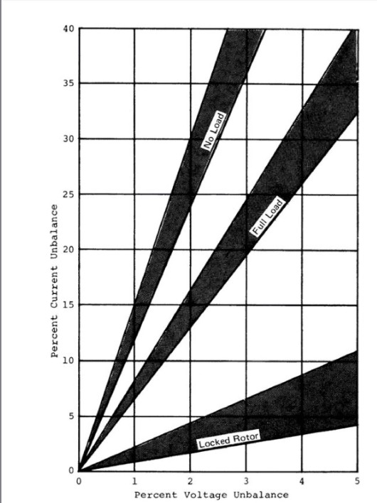

condemning a motor based on relatively low current unbalance without measuring voltage balance is generally not advisable.
the expected current unbalance caused by voltage unbalance can be a heckuva lot higher than the voltage unbalance in a normal healthy motor
go to books.google.com and search for motor current unbalance and look for the results in "Energy-Efficient Electric Motors, Revised and Expanded" (excerpt below)

I have traced this down to phase imbalance, I think. The loaded motor is drawing 634, 591, 587 A, and the voltages are within 2 volts.
