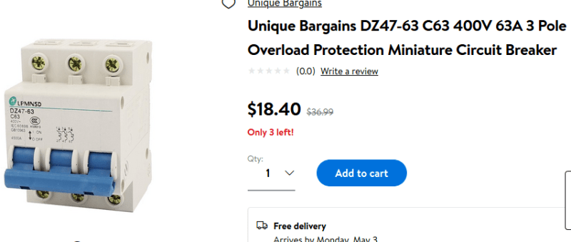

I do not recognize any of the brand names on the Walmart or Amazon listing.
Please note - I am not claiming these parts are counterfeit, or that they will not perform as claimed. The "Brand Name" on the counterfeit in the linked video does not appear in any of the amazon or walmart links, above. A casual examination might not discover the counterfeit.
In the Walmart and Amazon links, a few of the breakers DZ47 have a CE mark, most do not. None display a UL or CSA mark, about half carry the China Compulsory Certificate mark, commonly known as a CCC, Many have NO safety certification mark.
The counterfeit displays a CCC Mark.
The lack of third party certification would create trouble for the user if an AHJ is inspecting the installation (CCC would not count in the US, CE might get accepted).

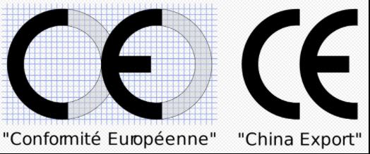

The chines make the CE mark different so EU can't claim it's a plagiat and a conscious fake.
CCC hm don't know how come up with that the Russians maybe ;-)

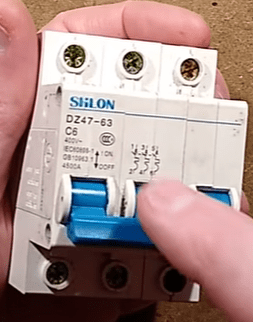

This is definitely a fake, not a switch.
The little graphic is showing thermal trips and magnetic trips that don't exist.

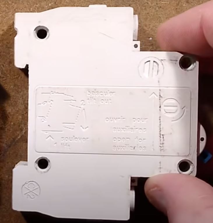

When he disassembles the switch, on the sides, the moulded in markings indicate that it is a disconnect switch and not a breaker.
The only information molded on the sides are information about how to put it in place and which way it should be placed.
In French and English

In our world, Tug, the graphic on the front of the breaker clearly indicates a thermal trip and a magnetic trip, niether of which is present.
This line of devices badly needs a flotation test.
