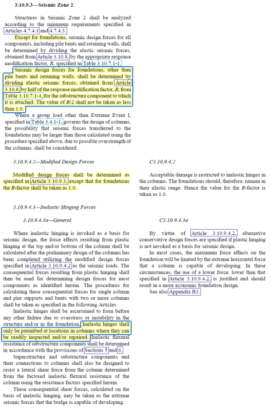

Theoretically, I don't see any issues with allowing the piles to hinge, but from a code perspective and a practical and serviceability standpoint there is no way to inspect the level of damage and then go in and make the necessary repairs since they are beneath the ground. The inelastic straining that takes place in the pile will usually necessitate a repair.
I was thinking specifically of AASHTO 3.10.9.3 and 3.10.9.4.3 which essentially require all hinging to occur in the substructure elements above the pile/shaft. For Seismic Zone 3 it specifically states that foundations shall be designed for R=1
For the way we use them, the hinging of steel piles doesn't compromise their functionality, under service conditions or seismic. The first 3 highlighted portions only address the calculation of seismic design forces, and the last one addresses inelastic hinging of columns. If you have a column that loses capacity due to inelastic hinging (such as a concrete column), then of course, it would need to be in an inspectable location, so that the reduction in capacity can be assessed.
Anyway, the 2nd highlighted area would indicate that the foundation elements are expected to reach their plastic moment, thus the reason for dividing by an "R" factor reduced by half, which effectively doubles the design forces.

I don't know what provision of AASHTO you think you are violating? Take a look at 3.10.9.1 (7th Edition is all I have in front of me). For a single span bridge you only need to meet the minimum support length requirements, and design forces for bearings follow the equation for As. However, for an integral abutment you don't have bearings and don't need the minimum support length since the girders are cast into the abutment. You also don't know exactly how an IA behaves so assuming a hinge in the pile versus the abutment rotating about the top of the piles is a moot point - nobody knows what happens. AASHTO is virtually silent on Integral Abutments so don't read too much into the code as it isn't very helpful.
