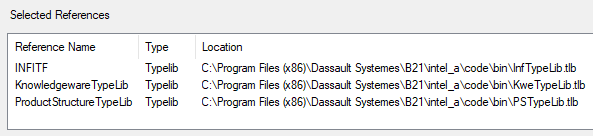

In "itsmyjob" solution and other solutions. The dev using:
Interop.KnowledgewareTypeLib.dll
Interop.INFITF.dll
Interop.ProductStructureTypeLib.dll
Question: Where I’m I suppose to get those? Where are they from?
Interop.INFITF.dll
