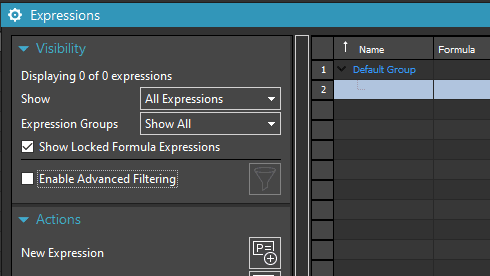

We have upgraded to V 2212 and I am trying to create interpart expressions.
When is create them I cannot see them and cannot filter them which makes me think that I may not have created them.
I opened older parts that I know have them and cannot see them in those parts.
Why am I not able to create new or see them.
In the expression visibility section, try setting "show" to "all expressions" (or "interpart expressions") and "expression groups" to "show all".
www.nxjournaling.com
Thank you.
I hade both set to show all but did not have LOCKED FORMULA checked.
