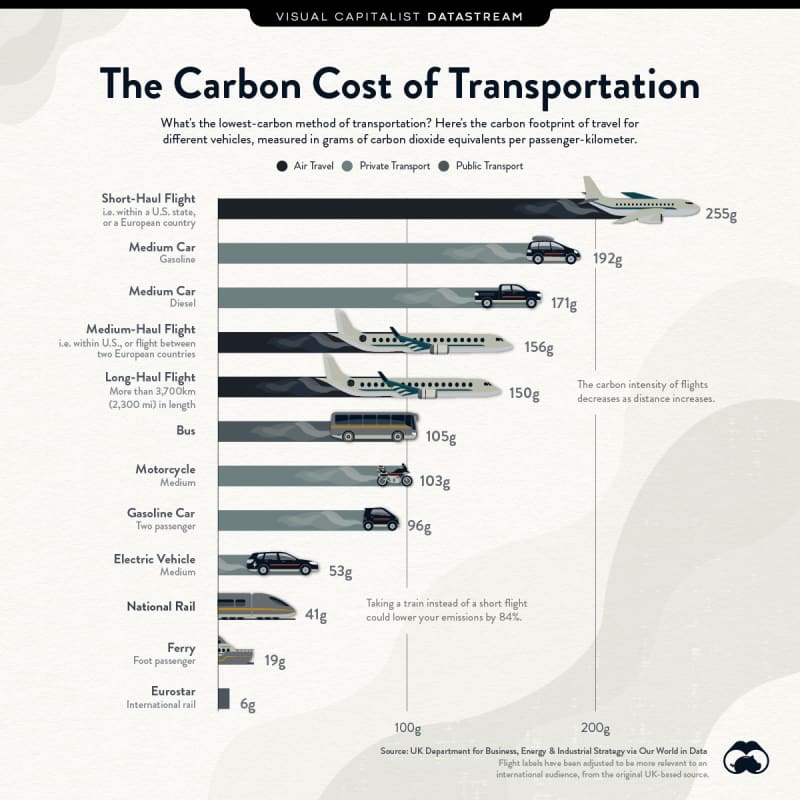

I wonder if there will be an impact on the following transportation?
I never understood the infatuation with rail. It doesn't pick you up or take you where you want to go so there must always be a secondary level of transportation.
Road is made from waste product, asphalt, while rail is premium manganese steel.
Rail is hampered by bottlenecks and breakdowns.
Personal vehicles are a form of scaling. Less demand means less personal vehicles. Rail must always run the same number of engines regardless of spontaneous demand.
