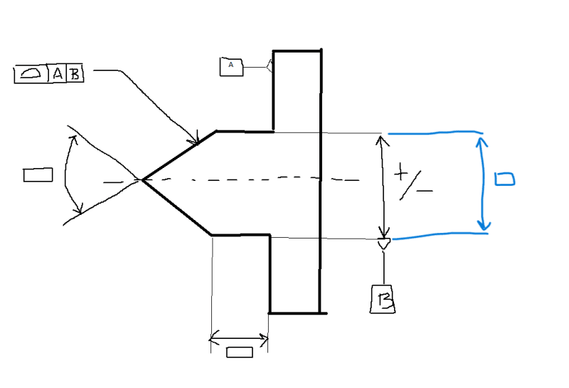

Hi All,
Having this debate at work. We use ISO GPS (BS 8888) but happy to hear how it applies to ASME Y14.5, I am sure it's not that different.
Problem:
How to fully define the profile/surface tolerance of a cone? As you can see from the image attached (apologies for using paint), I am trying to define a cone relative to datums A and B (a third datum would be pointless here as it is a revolved feature).
The shaft it sits at the tip of needs to be a linear dimension since it is defined as a shaft fit tol.
Are the two basic dimensions enough to define the cone? I feel like to locate the idealised cone from which to generate the surf. tol. you would require a basic dimension on the shaft as well. Otherwise the angle and offset from datum A can still be respected but the diameter of the cone be miles out. But i already defined the shaft diameter, just not with a basic/TED dim.
Do i need to dimension the shaft twice in my drawing, one TED and one linear? Fig. 8-18 on ASME Y14.5 seems to imply that you do not but its not super clear.
Thank you in advance.
I think is IF you add a basic distance on the angular surface /conical feature and then add its coresponding its basic diameter THEN you would have a robust cone definition.
So, at basic distance is this/indicated basic diameter (again somewhere on the conical feature)
I would suggest not measuring to an edge of the taper. If that taper is ground, that edge is not very robust to measure to. I would suggest using Gage dimensions to control the diameter and size of taper
For the purposes of TED/Basic definition of the conical surface (to provide the basis for the profile of a surface tol. zone), you can either dimension a basic diameter on the cone on some basic "gage line" distance from datum A, or just give a basic distance from datum A to the cone's apex point. In either case do not dimension to the intersection edge with the +/- shaft diameter.
Thank you for the replies.
Burunduk: so are you saying to dimension the cone base twice? one TED and one linear? I ended up dimensioning to the apex of the cone.
But the question still stands if "legally" i can dimension twice in these kinds of situations. Although i dont have another example in mind it does happen when mixing GD&T with linear dims.
Regarding no dimensioning to the intersection edge. It is functional in my case and we are able to inspect it, so that has to stay.
SDETERS: I am not sure i understand the meaning of "gauge" dimensions.
rfkflf,
When I said you can "dimension a basic diameter on the cone on some basic "gage line" distance from datum A" I meant some intermediate diameter on the conical surface, somewhere between the apex and the cylindrical shaft. The location of the section of that size would be set by a basic dimension from datum A. Don't re-dimension a directly toleranced diameter by a basic diameter.
A basic dimension from datum A to the apex of the cone (as you say you did) achieves the same, so it's a matter of convenience how you give the basic dimensions to fully define the nominal cone.
Burunduk,
Ok thank you! I'll use the gauge line idea just because it feels wrong to dimension twice. Although technically I still feel it is correct to have a TED and a linear dimension because they are being used for separate requirements and in the end both requirements need to pass for the part to be good.
You say that it feels wrong to you to dimension twice, AND you feel it is correct at the same time. I understand about the different purposes, yet for me it feels more wrong than right.
