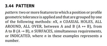

Theoretically, the part could have no datums at all and every feature of the part, including the datum features, might be controlled with a general profile with no datums from the general note, but then a philosophical question might be asked if this way of defining profile requirement would technically be a pattern/group creation mechanism, thus if it would be "strong" enough to impose mutual relationship between the features. Note that the definition of pattern given in para. 3.44 in Y14.5-2018 does not list "datumless-profile-specified-in-general-note" as a grouping mechanism. So to mitigate the risk, the general note would need to clearly say that the profile requirement applies to all part features simultaneously.
In regards to that, wouldn't the para. 11.3.1.5 in Y14.5-2018 cover the all over? It doesn't specify to say "all over" when you place the note in the drawing general notes?
"All Over Specification. A profile tolerance maybe applied all over the three-dimensional profile of a part UOS. It shall be applied in one of the following ways: c) place the profile tolerance requirement in the general tolerance block or general notes"

Imagine that the general note is like this:
UNLESS OTHERWISE SPECIFIED, |PROF|.04|.
(Notice that, according to the problem statement, I did not specify any datums in the profile FCF.)
So it is rather clear that this note applies to every surface that doesn't have an "otherwise specified" control, but the problem remains as the note, due to the fact that the FCF has no datums referenced, doesn't clarify whether these surfaces should be treated as a pattern of surfaces (that is, all surfaces are tied with each other per their mutual basic relationship) or individually.
Therefore, to clarify, the note should rather look like this:
UNLESS OTHERWISE SPECIFIED, |PROF|.04| SIMULTANEOUSLY
or something to that extent.
Without "SIMULTANEOUSLY," the clear and obvious default interpretation is they depart each other into space like confetti fired from a cannon. /s

UNLESS OTHERWISE SPECIFIED covers the part. It makes a single group of all surfaces that are have no other specification.
The implementation problem is if those UNLESS OTHERWISE SPECIFIED surfaces are not used as datum features.
UOS doesn't imply that the control mutually locates and orients the considered features. It only tells you which surfaces are under that requirement, but the requirement could apply to each surface individually. Seperate features are mutually controlled by profile or position only if they are grouped as a pattern and basic dimensions connecting them are given in one way (drawing) or another (model).
No mention of UNLESS OTHERWISE SPECIFIED in that definition.
