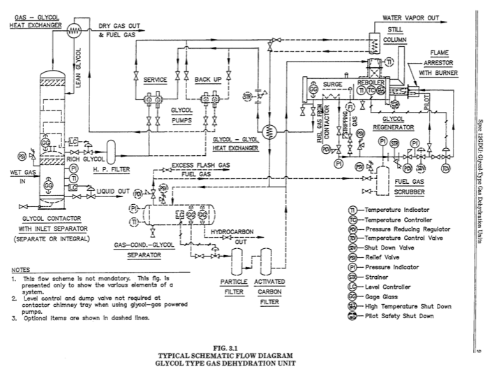

Glycol dehydrator reboiler still columns with vents to atmosphere in the Alberta oil & gas industry used to be commonly designed without relief devices until a few fatal incidents due to freeze off in the 1980's. Now they all have relief devices.

@ProsafPlant1, i fail to see how a relief device would be more safe? Is it because the continuous flow of moist air would cause condensation in the vent that would freeze and eventually _block_ the pipe and since there is no flow in the PSV then this wont happen in the PSV tail pipe?
This would only have to be considered in harsh environments then. Although, if you do see a way that the vent could be blocked then this could lead to a requirement for a PSV. Now one other way could be a very short vent stack? Here the vented flow would not cool sufficiently to allow freezing?

georgeverghese, ideally the vent discharge is just water vapour, but typically can contain various components of the raw gas stream often both flammable and/or toxic, which is why they are now typically directed to containment / recovery.
MortenA, yes the continuous hot water vapour / steam flow was expected to keep the vent line free of ice, but condensate-soaked permeable insulation, build up of ice mounds to the vent line termination, and loss of heat tracing were contributing causes to vents plugging.
Some fixes were a glycol filled U-tube on the reboiler, or "thief hatch" type relief devices on either the reboiler or top of still column.
I've attached an old API P&ID which shows relief devices on the contactor and separator vessels but not on the reboiler / still column.
@prosafplant, in the old days , glycol still vents went straight to atmospheric disposal. And the potential for blocked discharge on these still vents in modern installations where organics recovery schemes are implemented is the reason why PSVs' are installed nowadays.
