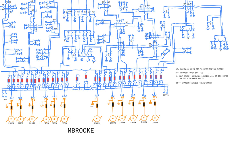

If curious, here is what I have in mind. 3000MW generating station; 2,250-2,500 MW peak loading.
Half load circuits- ie transmission lines rated 3000amps thermal, 1,500 amp actual peak loading. About 150-300MVA per circuit. Normally open ties to the neighboring system.
I know, the drawing far from perfect lol- but to give readers and idea.

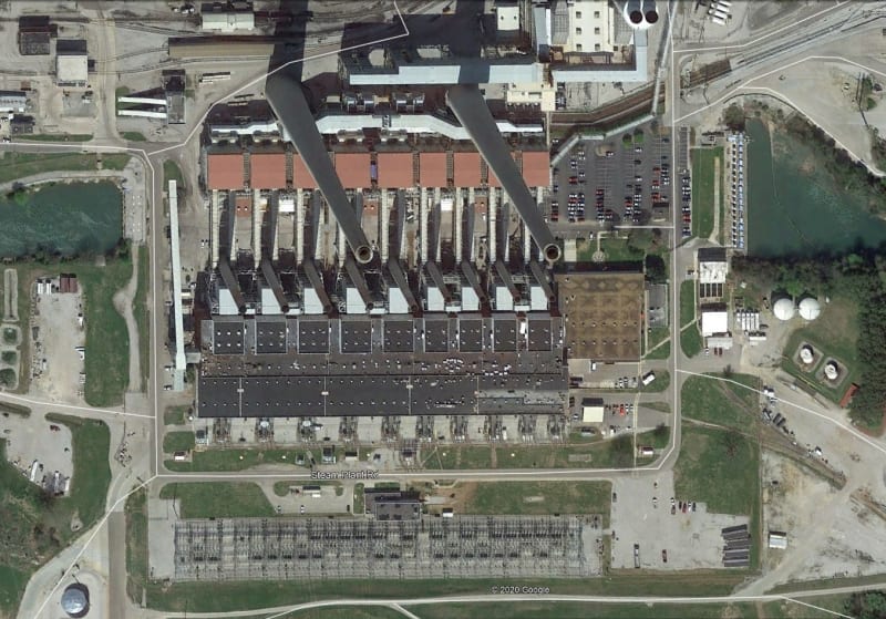

FWIW, here is an example of a generic station type I have in mind . I should have posted this earlier. 10 units- about 250MWs a piece.
When the plant is grid connected the sets will be base loaded and the swing set may be elsewhere.
When the plant becomes islanded, it will revert to 5% droop control.
If the island is exporting power, the frequency will rise and stabilize on the 5% droop curve.
If the island is importing power the frequency will drop on the 5% droop curve.
If the island load is greater than the plant capacity steps should be taken to shed some load.
