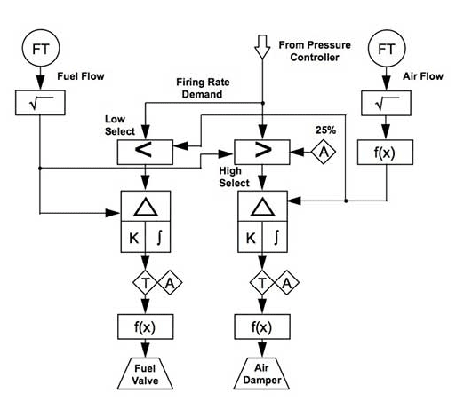

Regarding firing rate controls for large boiler this link has a reasonable explanation of cross limiting air fuel ratio controls. The flame safety supervisor is a separate system.
The clip is just the basics. usually there are additional components like air - fuel ratio trim, etc.
The water level controls system is similarly complex.
Tuning a boiler operating control system is a chore.

Electronic controls can be very fast, but often if too fast they have control stability problems.
In the coal fired steam plant crshears discusses units 1 and 2 were perhaps a bit slow, 3 & 4 sound like they are faster than they needed to be and likely would have trouble getting air fuel trim to work well. Air Fuel O2 trim always disables itself when the firing rate changes significantly.

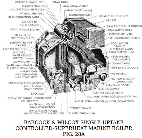

On the other hand many Navy marine boilers on needed to pass a test which ramped the firing rate from 20% load to 80% load in 90 seconds with no smoke at the stack (found this in a WW2 B&W type M Boiler manual). The Navy was OK with the high maintenance costs of these very responsive boilers, as the get up and go in a hurry is sometime a lifesaver.
(from During the Pearl Harbor attack USS_Aylwin_(DD-355) was able to get underway from nearly cold iron while under fire. states that the event starts with one boiler steaming auxiliaries only, 15 minutes to main steam on line, two boilers 25 minutes (8 minutes after main steam was on line) from start of the event and they were away from the pier and heading out of the harbor at full speed.
Per design shaft horsepower was 2x42800. More background here
