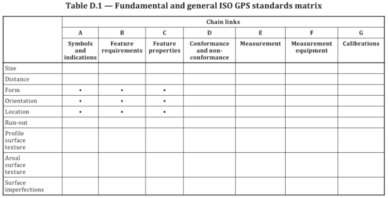

The answer must lie somewhere in the end of ISO 13715 standard book.
If the book has diagram showing place of 13715 somewhere here:
then it is part of GPS matrix and, naturally, part of GPS.
Anyone in possession of actual book please disprove or confirm.

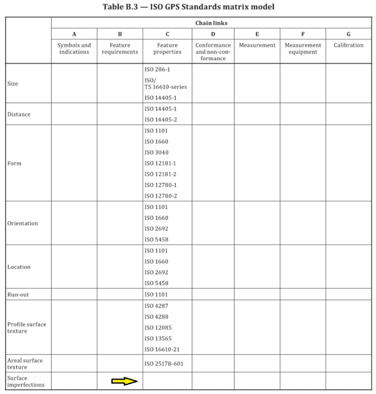

I can’t find out any matrix table from ISO 13715-2017, and I noticed there are some changes since 2015 on ISO 14638 Geometrical Product Specifications (GPS)---Matrix Model. We may notice the differences between them.
And the changes reflected on all revised standard after 2015, following is a snapshot from ISO 1660-2017 matrix table.

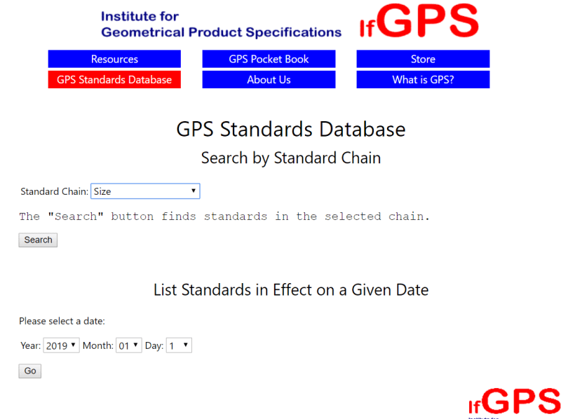

From the title of the above standards, I don’t think it’s an ISO-GPS relevant Standards, you may find out all ISO-GPS relevant Standards list from the attached below, but it may not be the latest edition.
As for ISO 13715, it’s an ISO-GPS relevant Standard for sure in the past, but I’m not quite sure for the time being since I can’t find out any statement of ISO 13715 in ISO 14638-2015 as shown below.
There are 18 geometrical characteristic of features in ISO 14638-1995 (as posted at 4-19), it reduced to 9 geometrical properties by ISO 14638-2015 (as posted at 4-19). Angles are covered within the properties of size and distance, and Radii are covered within the properties distance and form. Datums are no longer covered by a chain in the metrix as they are not geometrical properties. Edges supposed to be covered within Surface imperfections, unforturnately it is not included.
You may find all chains link ISO-GPS relevant standards from the "GPS Standards Database" linked below.
Season
