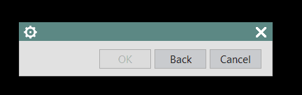

Hi Cowski,
Quickly tested your tool.
After I have been prompted to select a view, I am asked to pick a point. The question is however not showing in the point picker.
(would be nice to see it in the topbar of the point picker)
Only in the command bar at the bottom.
After picking the point it places the triad just fine.

@NutAce,
I agree, I would like to see the prompt text in the dialog itself. However, this isn't how the command works and I have no control over the text placement. Hopefully they will update the NXOpen dialogs in a future version of NX, but I suspect the "solution" would be to use a blockstyler dialog (which I don't have a license for at the moment).
