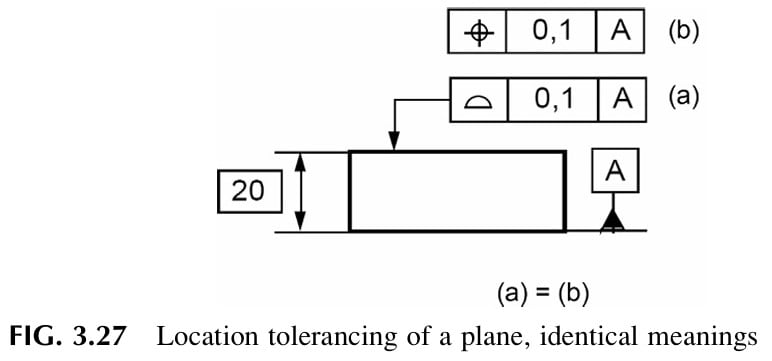

Hi Everyone,
I've got another ISO GPS question for you from a customer-supplied print:
In the image below, aren't the [Position|0.1|A] & [Profile|0.1|A] controlling the exact same thing? I'm struggling to get a response from the customer on this one, was hoping you could provide some insight. To me, both controls create a 0.1mm tolerance zone nominally located [1.8] from Datum A. Am I interpreting this incorrectly?
For context, their intent is to control Surface 1 with these callouts (this is a cylindrical feature ~6mm in diameter). Datum A is defined as the end of the standoffs (Surface 2) shown in another drawing view.

Surface Profile and Position act the same on a planar surface in ISO GPS, but you are saying it's a cylindrical surface?
I'd say snippet shows too little to understand the problem and form an unequivocal conclusion.

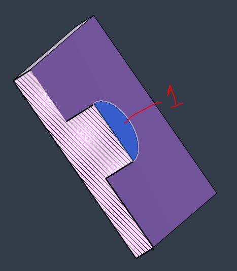

Sorry, I did a poor job of explaining that. Surface 1 is the planar surface at the end of a cylindrical feature. Example Below.
Mech1595,
You are correct. The position and profile callouts control the same thing.
The use of the position symbol is allowed according to ISO 1101, but only for planar features.
Both position and profile callout indicate the location of planar feature.
Ok, so it's the flat end of a boss. That also explains why there is a flatness specification.
BTW, Ra of 0.0125 micrometers requires the surface to be extremely smooth. So polishing is totally relevant.
A quick correction, just for the record: ISO allows position not only for planar features, but also for cylindrical features of size (holes, pins, etc.).
What you said is absolutely right.
We are talking about the legitimacy of the location tolerance on an integral surfaces, whether it meets the requirements of the ISO standards. On this particular case, position is allowed to use on the planar features only.
