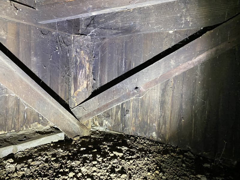

I've never seen one of this type. But speaking theoretically, strip footings provide some kind of water barrier, depending on how well it's constructed. I know these types of isolated footing buildings have been around for a long time. But for a new design, I wouldn't do it because of potential water infiltration. I also don't like crawl spaces for the same reason, but people keep building them. (shrugs) I guess if things are pressure treated like an outside porch or deck, it should be okay.
Putting bracing on, I'm not sure how well that would work compared to legit shear walls on strip foundations. Nail capacity and all of that. But then again, so many old buildings are still standing, so historic empirical design has merit.
I love crawl spaces. As long as they are properly designed, detailed, and constructed, you can't beat them for the ability to conduct maintenance and make modifications down the line.

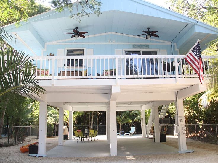

Where is the water going to infiltrate if the entire structure is above grade? Water infiltration is mostly an issue when you are sitting close to grade or below grade.
Some of the variance in construction comes down to local requirements. Frost heave is a big deal in frost environments with foundations so deep you might as well throw in a basement. Alternatively you bigger challenges might be storm surges so you end up designing quite differently.
Likewise as soon as you a building a house on a steep slope you will start likely to struggle if you try stick to slabs and strip footings.
Different foundations for different needs.
@human909 That structure looks like a reverse pendulum. I've seen those types of houses in flood zones. Not my cup of tea, but they work. And yes, you're right; nowhere for water to infiltrate. I was thinking along the lines of something that had an enclosed crawl space with the post and beam system.

I've designed a couple of stilt houses. They are not fun. Down in NC they have a prescriptive design procedure for those. They don't calc out. At all. So it's really fun when you get a builder who's already frustrated that they have to get an engineer to give them a foundation design for a house that's slightly out of the prescriptive scope...and I have to tell them to put in 3 times as many piles as they were expecting...
