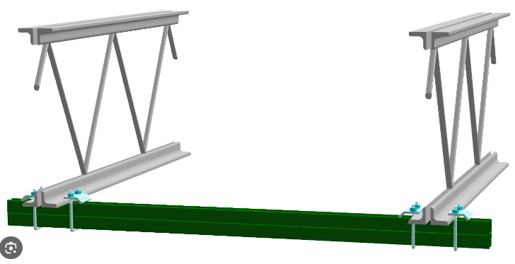

Has anyone "designed" a hanger like shown in the attached sketch? I've seen them used occasionally in mine processing plants but I assumed they were just remnants of decades old practices.
I've been asked to use this concept to support a walkway stringer from the bottom chord of a box truss conveyor. Typically I would have a bolt through the horizontal leg of the bottom chord and the horizontal leg of the stringer. I can get grade B7 J bolts but there's concentrated forces in the bend, shear and bending in addition to the tension. Applied load will be less than 4 kips so gut feeling is that it will probably work. Still, a quick image search online shows plenty of pics using the j bolt to clamp down a bar grating or such but none using it as a hanger. I need to put a capacity to the connection if I'm going to use it and that is making me lean toward avoiding the connection.

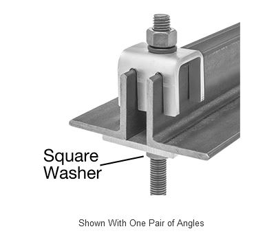

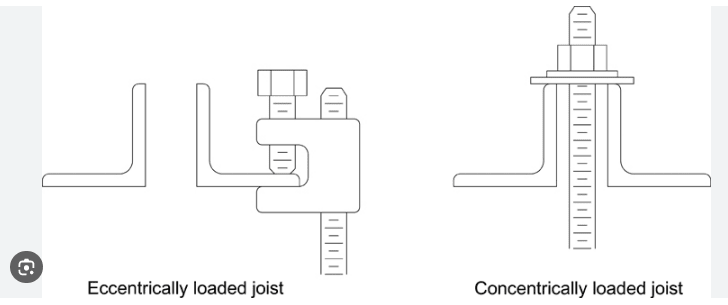

McMaster-Carr has a variation on your hanger bolt that eliminates the bend, but not rated adequately. You could look around to see if some higher-rated version exists. McM only sells what somebody else makes. You would need to have the second vertical leg as part of your weldment.
hanger
I would avoid and go with some more common like threaded rods, beam clamps, etc. I think the J bolt approach is an older approach.
Thanks for all of the confirmations. I knew I didn't like the connection but I like to have a good reason for dismissing a contractor's request.
Those are some pretty useful connectors posted above if I had two angles. I also considered drilling an extra hole and using a large U-bolt but at that point it's just as easy to use a structural bolt through the bottom chord.
