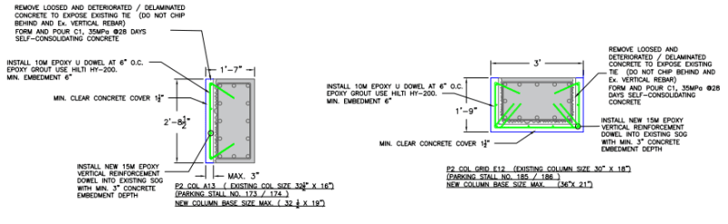

Found the detail from the EOR
We couldn't do exactly what they wanted as the angles into the column were impossible to facilitate on both ends with a single stirrup. We therefore epoxied the angled stirrups into the column on a single side and welded the laps.
Amazingly, the detail you have shared is pretty much same which I have finally given them based on my understanding. However, the stirrups I have shown in the detail were not bent to 135[sup]o[/sup] as you have shown and just 90[sup]o[/sup] with around 50mm embedment into the existing concrete. I really do hope that doesn't possess much of an issue in the performance.
Also a big thanks to you for remembering and posting the details.
Only 50mm embedment into the existing concrete? Seems quite low. Wouldn't you want to develop the bar into the existing concrete?

50mm of embedment won't even hold the jacket to the main concrete. Or at least not confidently. Provide real embedment.
