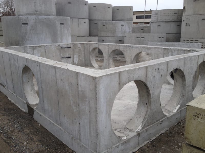

The top slab was designed as a bridge deck with reinforcement perpendicular or parallel to traffic depending on the situation. The walls over the pipe penetrations were designed as simply supported or continuous beams carrying the top slab. The walls between the pipes were treated as columns for the top slab loads and cantilever beams for the lateral loads. Bottom slab was designed as a one way slab.
Pretty much the way I would approach it, except the walls would be treated as flexural items, too. I wouldn't rely on the pipes to provide lateral restraint.[pipe]

dik - For the wall between the pipes, I didn't assume any lateral restrain from the pipes. This is a picture of one of the largest boxes.
