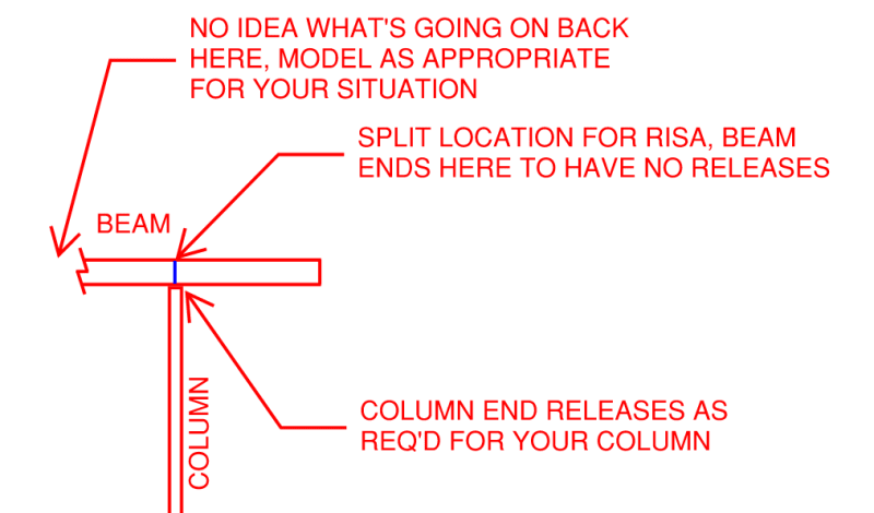

EngDM,
This is my understanding of what you're doing - running a beam over the column that in reality will be continuous, but in RISA you split it there so that whatever's going on with the beam on the non-cantilever side of the column isn't affected by the design parameters you need for the cantilever portion:
Pretty close to your sketch, except with a spliced beam on the RHS. For the connection to the spliced beam, I imagine I'd use a pin support? Your diagram above says ends, plural, to have no releases.

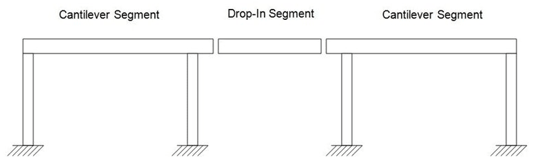

Can you post a sketch?
I'm talking AISC, the K stuff you're talking about is CISC, if I'm not missing something. I suppose you're using the Canadian design codes where it's more involved.
If you're really doing cantilever suspended span, you'd include the other drop-in beam. That would be pin connected to the "free" end of the cantilever.
