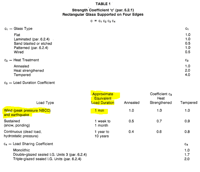

P.S. I found a table from the CGSB 12.20 M-89 (canadian glass design code) that appears to indicate wind load determined from NBCC (which is an hourly mean) should be treated as an approximately 1-minute load duration. I think that is the answer I will use, except I have no idea where that 1 minute came from. If anyone has any background on this that would be much appreciated.

From CGSB, if you read table 1 & table 3, it basically suggest that wind load ~ 1 minute load duration, and with that load duration if you look in table 3, you can assume "monolithic" even for laminated glass.
I read more into ASTM E1300-16, which is a lot more recent and contains a bit more commentary. It is pretty clear that we should be using 3 second and assume 50 degrees for the laminated glass. In practice, this ends up being a partially composite glass.
So in the end, ASTM E1300-16's approach as it is more understandable, and is more recent, so I will follow that. As for my project I'd have to switch up to using SGP for the laminates instead of PVB if I want to keep my glass thin. Thanks again!
