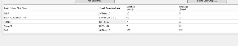

Here is the load history I used:
All Dead = self weight of the slab only, I did not apply any superimposed dead loads
CL = L = 20 psf on the entire slab for Construction Live Load
Tp = Thermal load of +120 top +40 bottom assumes sun exposure on the top surface
Tm = Thermal load of -40 top and -40 bottom assumed uniform cooling

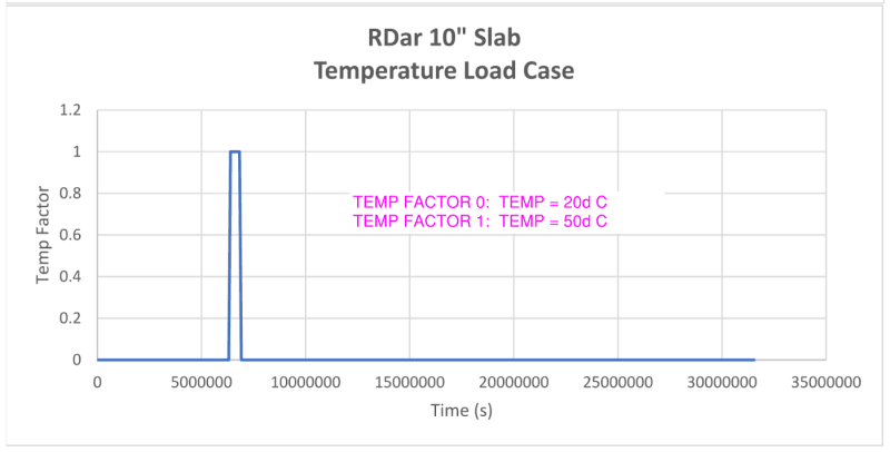

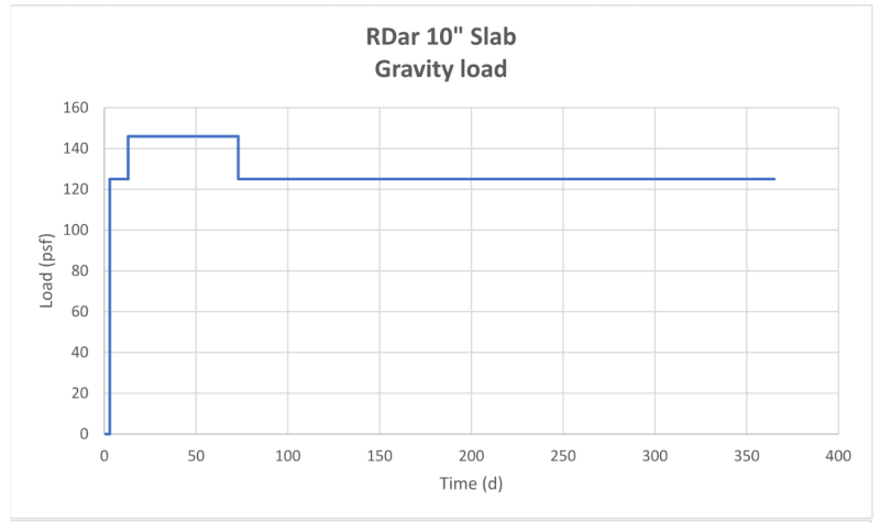

I have been noodling this problem for my own continuing professional development off and on for a bit. I thought I would share a few thoughts.
I used loads similar to Celt. Mapping the time steps in the software I use is a tad bit more onerous, so I created a spreadsheet of the functions needed.

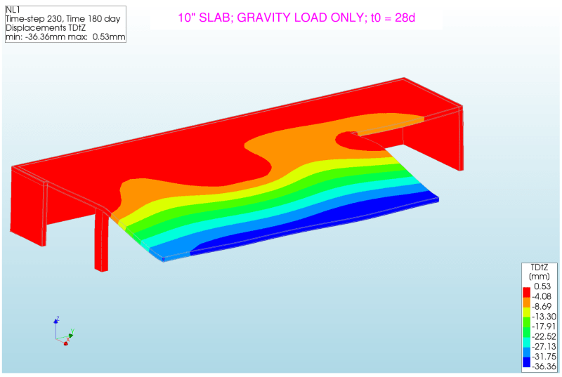

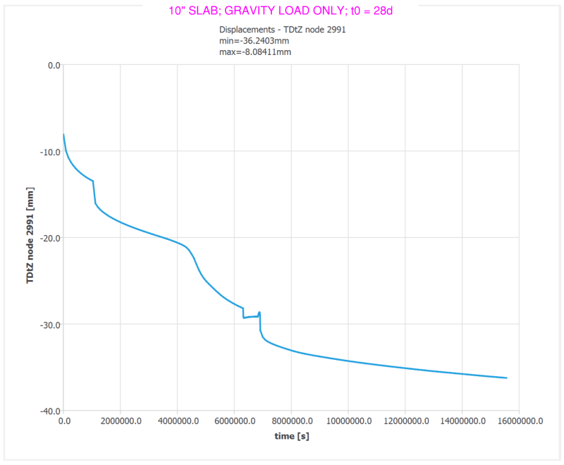

The first analysis is below. The deflection in this case was much lower than reported. This analysis assumed the concrete age, t0, was 28d when the load steps started. That was not the case here.

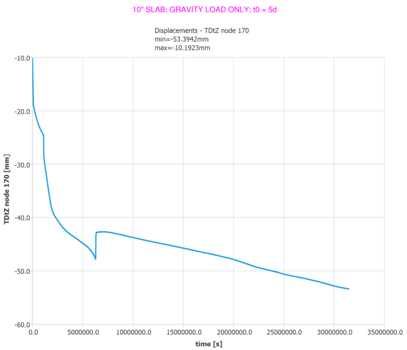

I re-ran the analysis using a t0=5d. Here I did not include the temperature load case. The deflections are closer to what is being reported.

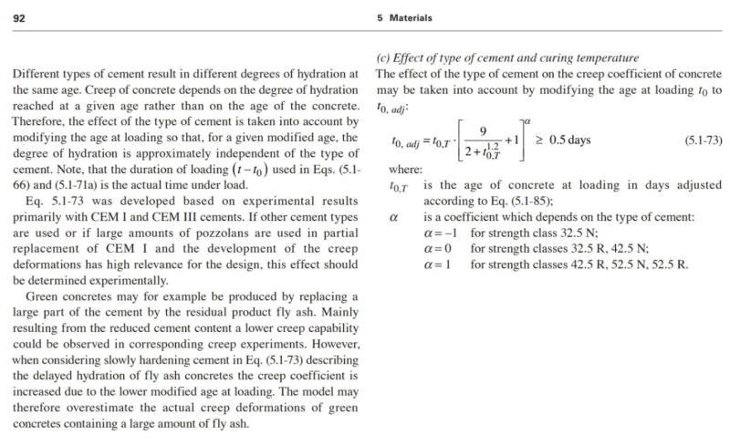

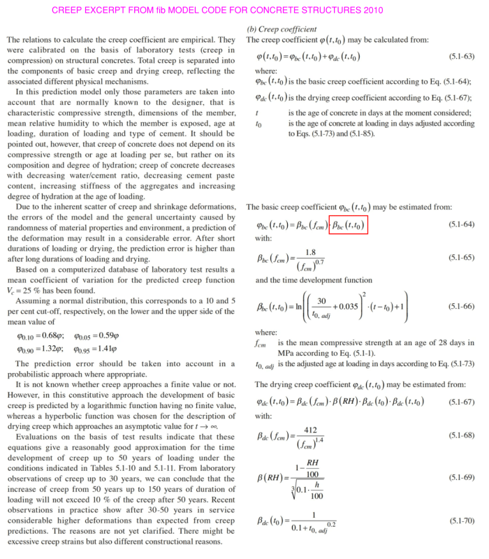

Now you may say, but we used a high early admixture. I think you have created a design that is very sensitive to creep and shrinkage. Do you know how the curing methods or admixtures affect the hydration process? You need to look at that carefully. Below are some excerpts from the CEB fib Model code 2010. In this you can see how the age of loading affects your creep parameters. Shrinkage can be affected similarly. I am sure Celt adjusted his parameters correctly, but I am not sure you have nor considered this in detail.
To show the impact of the age of loading on the basic creep coefficient I created a simple calculation of the value for 3/7/28 d below.

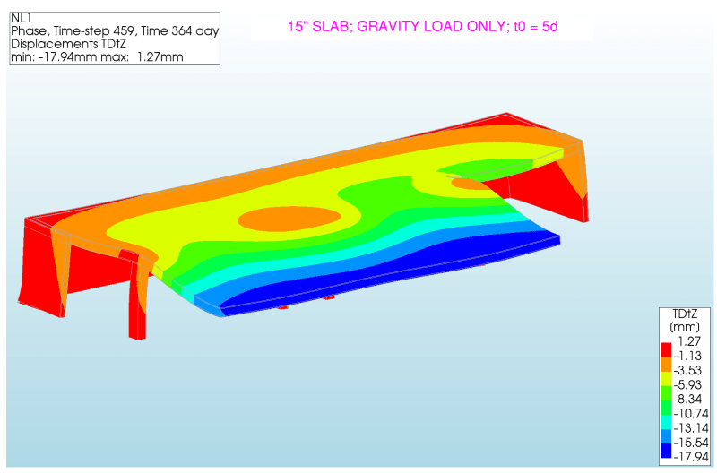

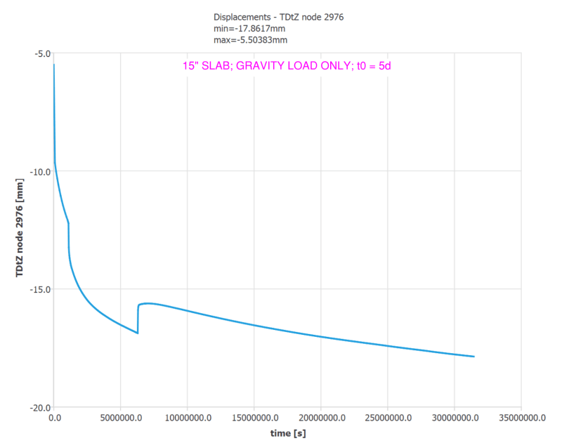

At this point you probably think, but everyone uses high early admixtures and strips forms as we did. The key difference is most do not use designs with this span/depth ratio. To show the difference I reran the design if the slab were 15" thick. I am not suggesting that is an appropriate design nor cost effective. It is merely to illustrate the benefit of using the span/depth ratios suggested. This analysis was subjected to the same load case, and the t0 = 5d.
