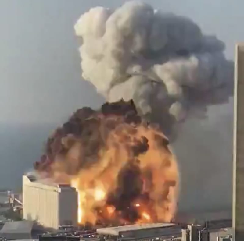

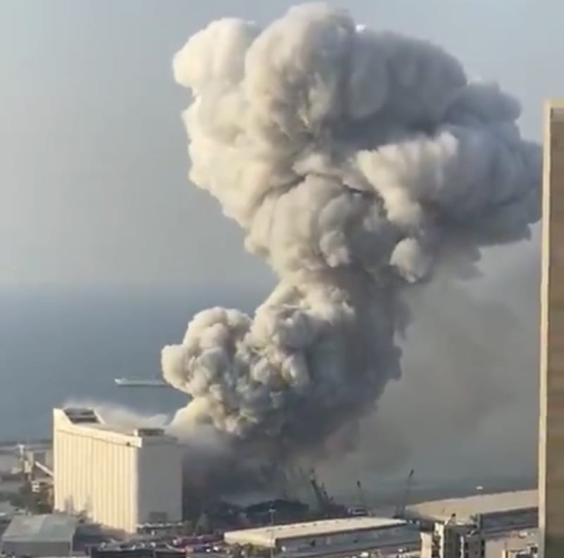

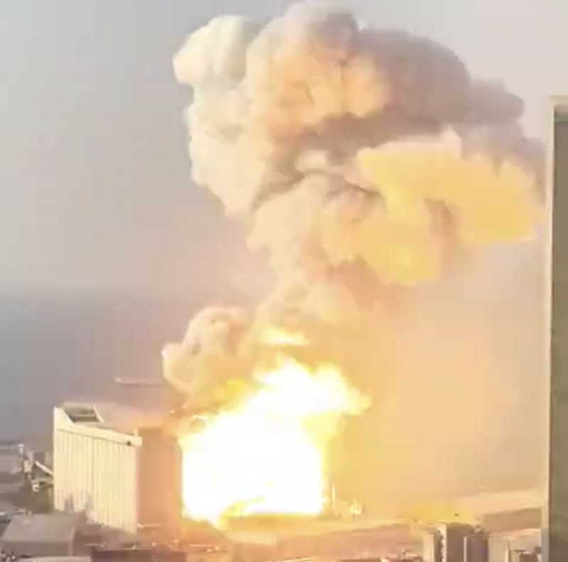

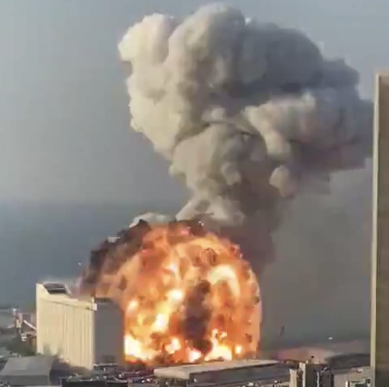

I think that this is one of the definitive views of the explosion:
It almost looks like the fire originated in the warehouse adjacent to the one that was completely obliterated.
Some stills:
That's was what I said in my 8 Aug 20 05:43 post...
"Also, from the videos, it looked like the initial fire/explosion could have come from that first warehouse, closer to the end of the pier, as seen in the aerial photos."

In Beirut, how long between the initial fire and the first explosion? Could a proper sprinkler system have prevented the AN explosion after the initial fire?
