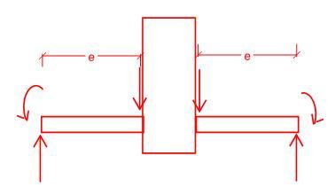

KootK said:
An interesting feature of the detail is that it uses fillet weld pairs in bending to resist gravity loads.
Care to explain this comment Koot? I only see the fillet welds resisting shear, but I am sure there is something I am missing.
Thanks!
Koot:
Actually, if I’m reading you comment about the pairs of fillet welds taking the bending action correctly (as you intended it), those welds really aren’t that unusual. Take a unit width (unit circumferential length) of the ring pl. at those welds; with a canti. length of [(D1 - D2)/2, +/-], the radial space btwn. the pipes, +/-; the gravity and lateral loads cause bending on the double fillets, plus shear perpendicular to and in the plane of the ring pl. This doesn’t really load or stress the welds appreciably differently than on a “T” joint with a tension/compression load on the “T” web, plus a bending force on the web. And, we see this detail quite often in everyday service. The important thing about the double fillets, and bending, is that they tend to protect the fillet roots, they prevent prying tension across the roots. Then, the resisting moment is the ring pl. thickness, plus, times the fillet weld cap’y. per inch of circumferential length.
I think I see it now. Needed to draw the FBD of the plate. Let me know if this is what you were referencing.
That's exactly it SNT. Perhaps without the moments at the ends depending on one's perspective.
