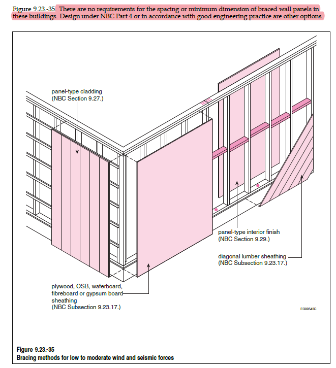

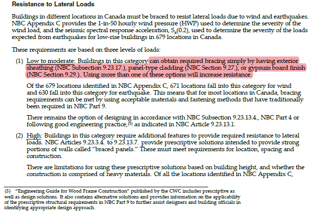

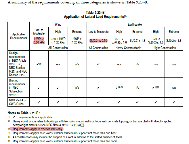

Design requirements in NBC Article 9.23.16.2.,NBC Section 9.27. and NBC Section 9.29 simply address sheathing & gypsom thickness, min. nailing requirements, etc. If I want to be safe will interpret older buildings that often don't have exterior sheathing OR interior gyproc sheathing OR panel cladding as prescribed, as not being elligible for this section and have to be laterally reinforced using engineering methods (Part 4 or CWC Engineering Guide) in case of major modifications. For newer construction where a whole exterior wall will be large windows for example, I will design LFRS using line loads on that wall alone as phamENG mentioned.
