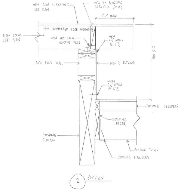

Jimey, can you show a sketch (embedded image) showing how this beam is installed and loaded?
Thank you all for your help. I think I found the answer I was looking for. Eurocode 5 Part 1-1 has a section 9.2.5.2 which gives the load that lateral bracing for timber members (including beams) should be designed for. But if anyone is still interested, I've attached a link to a sketch showing my exact situation.
 https://files.engineering.com/getfile.aspx?folder=347a72df-04d8-4636-bb7f-04ac813e310a&file=0749_001.pdf
It's a bit of a judgment call I suppose, but I think most engineers would consider the existing framing as providing acceptable lateral bracing of the glulam, despite it not being exactly at the top. I have trouble picturing the beam failing in lateral torsional buckling with that framing there. In terms of the buckling restraint force, I wouldn't normally calculate that, but if I did, I'd probably use 2% of the compression component of the moment.
Your sketch (for convenience):
