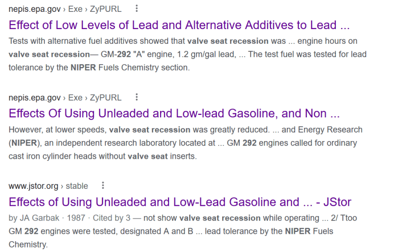

For example:
All anecdotal information. Tests with no data. "How ever tests at lower speeds valve seat recession was greatly reduced"
