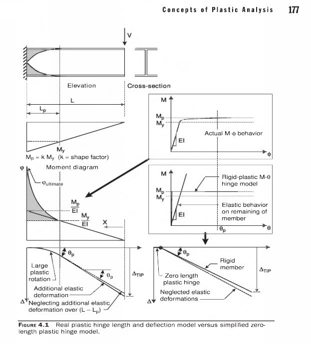

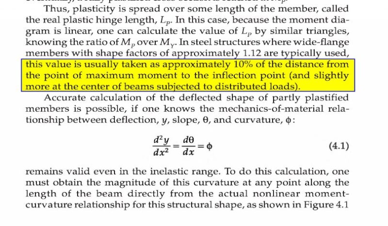

Can anyone tell or give reference to find length of plastic hinge in steel sections for beams and columns?
For example in RC sections, it is approximately 0.5 times of depth of the section.
Thanks, similar to the stuff that Maisonette (sp) and Save had for that time period. I've used plastic design for most building type stuff (where applicable) for over 50 years. Still take it seriously.
Seems to me, it depends on the moment diagram. If the plastic moment stretches out over a considerable length, that is the length of the plastic hinge.
My understanding is that it is fairly consistent, and occurs over a length approx 2x the depth (rough). It's normally used for simple continuous uniform framing where the moment is reasonably 'defined'. With this type of loading the first hinge occurs over the column (this is contained) and the second one occurs at 'mid span' (less defined). I've been aware of this but in half a century have never calculated it. If a PEMB were proportioned perfectly so that the elastic moment were exactly provided by frame... the entire structure would go into a plastic collapse at load. [lol]

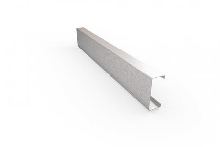

Any thoughts on using cold rolled sections in plastic design? These things are at the opposite end of class 1 sections. The main columns and rafter are 300mm deep and only 2.4mm thick to span 20m!
Not even after a bunch of beer... I often use a program called CUFSM for calculating the strength of CFS sections and they often go into local instability in areas of high moment. The reason plastic design uses Class 1 sections (at least in Canada) is to prevent this very thing... Plastic design requires that hinges can form and the structure can remain stable until the final hinge occurs. With plastic failure, but no collapse, the structure will remain elastic until the next load case exceeds the one that caused plastification.
