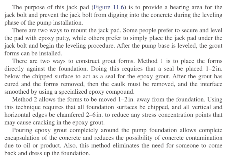

Does anyone know the pros & cons of not providing the "jack-pad"? (See HTURKAK's post on 1 Sep 20 14:24.)
I have to admit, I haven't done that before that I can recall.
The jack pad just helps distribute the point load of the bolt to the concrete to avoid local crushing. If it is lightly loaded, it may not be super necessary. If it is heavily loaded, when they turn the bolt to level the equipment, the bolt will crush and indent into the concrete and may make it more difficult (maybe impossible?) to get it precisely leveled. I have seen these plates embedded in the concrete when it is poured and also where the person(s) setting the equipment just placed them loose under the bolt.
Yes, to quote Harrison's book:
Thanks... saved to my HD... never to be found again... but, saved.
Thanks Ingenuity. I figured the stress of that bolt end would obviously be at issue.

He does indeed. His book (I have both 1st and 2nd Edition) is a 'soup to nuts' compendium. He compares cementitious and epoxy-based grouts, techniques, surface prep, mixing etc. He has entire chapters on each subject so it is a but difficult to detail them here.

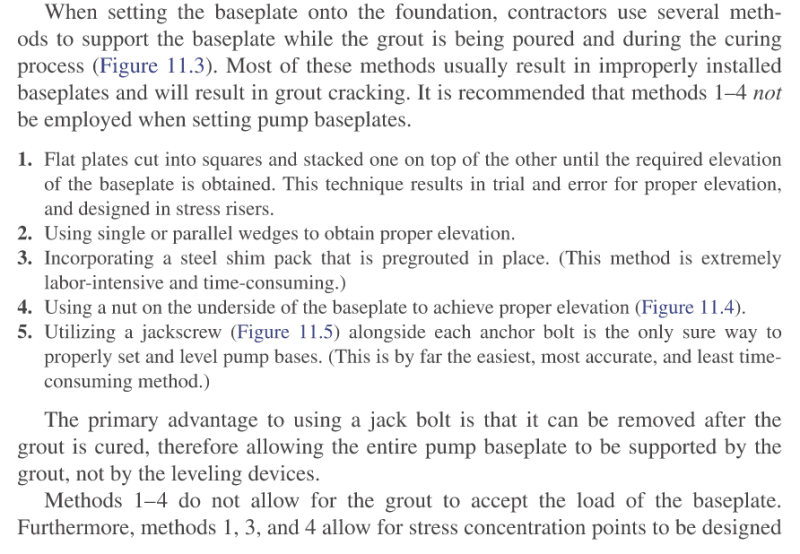

What is the pump OEM's recommendation for leveling? If they condone leveling nuts on the anchor bolts below the pump base be very afraid. Take measures to protect yourself.

Getting rid of those leveling nuts is the first step
Earlier this week, I found the following excerpt from a Flowserve manual (VERTICAL TURBINE PUMPS (VTPS) CENTRIFUGAL PUMPS ENGLISH 71569224 – 10-13). This manual was written for vertical turbine pumps, but imagine this provision applies to all pumps.
"If leveling nuts are used to level the base, they must be backed off as far as possible prior to grouting. Always shim near foundation bolts and then back off the leveling nuts. Now tighten the foundation bolts. If done otherwise there is a risk of significantly lowering the structural natural frequency that could result in separation of the base from the grout."
