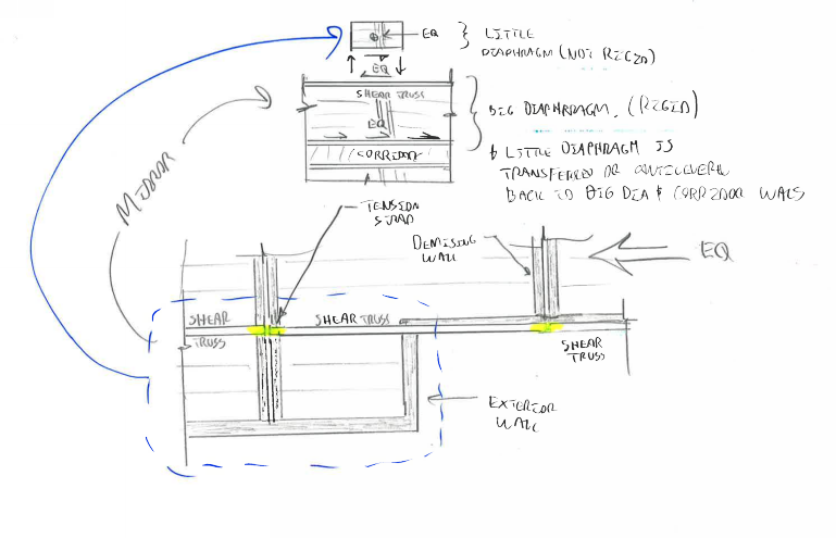

. When load is parallel to the corridor, these shear trusses or straps and blocking act as collectors to deliver load from the plan offsets. Since they are in a continuous line within each flexible diaphragm, the flexible diaphragm becomes a sort of transfer diaphragm for the rigid diaphragm.
RFreund said:
Let's call the rectangular diaphragm bounded by the most interior, exterior walls and/or the truss/blocking between them, the main diaphragm. So your plan offsets create areas of the diaphragm that our outside of the main diaphragm. When looking at forces parallel to the corridor walls - Do you consider the offset portions a cantilever diaphragm where you transfer shear at the previously mentioned trusses/blocking and develop the chord forces into the main diaphragm?
You're both talking about the phenomenon shown below where the chunk of diaphragm beyond the chord proper "rides along" with the main, rigid diaphragm, right? FWIW: I have no idea why I didn't draw my inset detail the same way up as the main plan. I'm too lazy to fix it unfortunately.

I was actually thinking your Query 1,2 and 4 were all the same. I had interpreted the "offset" to mean walls on the same floor being offset from eachother.
If they are offset too much, I just provide full depth blocking and a strap or a shear truss. I've found (and confirmed by talking to Terry Malone) that it is often better to just provide full depth collectors than try to detail transfer diaphragms.
I took this to mean that the collector extends across the depth of the diaphragm. I assume Mike means it is difficult to detail a transfer diaphragm because your collector must extend between chords, which means you would need a chord at the end of your collector. Although I'm still a bit fuzzy how the cantilever influences the main diaphragm design if it falls between perpendicular shear walls... I think I'm just adding to the confusion...

It's so difficult to explain without sketches, so I apologize if I was unclear. I was referring to horizontal offsets within the same plan rather than horizontal offsets between levels. I will avoid these vertical offsets at all costs, but I have done them before. You're diaphragm below takes a concentrated load from the shear wall above and a distributed load from the lateral loading at that level. I don't think it's possible to detail without having a transfer diaphragm at the level below; at least that is how I've done it. With plan horizontal offsets, you are basically tying the two offset walls together with a "lapped" collector. This only works because the corridor is detailed to be a full depth shear wall/collector and can handle the rotational force through it's shear panels for loading parallel to the corridor. See the attached example to see what I'm talking about. Hopefully it will become more clear and maybe clear up Query #2.
 http://files.engineering.com/getfile.aspx?folder=a4f47a4c-011e-4596-9efc-ea0e72febf96&file=plan_offset_shear_walls.pdf
KootK said:
How is it that the flexible diaphragms are transfer diaphragms for load parallel to corridor? They sound more like cantilevered diaphragms to me.
You are right, each flexible diaphragm is basically an open front structure for loading parallel to the corridor.
Yes, exactly. By the time you provide the additional chords and the blocking and strap to transfer the force, you're better off just providing full depth blocking and straps or a shear truss and strap. It results in less blocking and less straps overall. This is why I asked Terry about it. I like the idea of having transfer diaphragms, but they can be unnecessary when the diaphragm dimensions are relatively small. I posted a numerical example above showing the lapped shear walls in lieu of full depth blocking.
