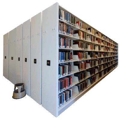

Our office was built with high density shelving similar to this:

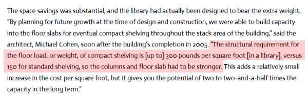

Floor loading can increase to 300 PSF:
I doubt a public library would use high density shelving for the everyday stacks, but they might for reference or archive areas.
Hey SRE - we did one like that where the architect had high density shelving on their slab on grade (filled with tile and brick samples, no less) and they wanted to move it up on a 60 psf office elevated slab. I took one look and said, "Nope".
I've had a few retrofit type jobs where they wanted to use High density filing like the ones shown there. And then they had the gall to complain when I gave them the required reinforcing to get it to work out. No amount of warning at the beginning about how much work it would be made them re-think the plan. Once they saw the amount of work required to accommodate it, magically they felt they could do without the high density part. So back to 100 psf storage loading.
