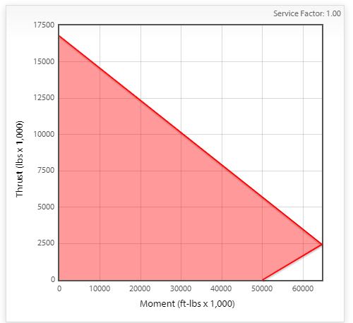

I interpret that drawing to show a bearing behind that nut that allows the hook to rotate. I would call that a slewing bearing if it was in one of my machines. Slewing bearings like this can be rated to loads in this range. The rating of the bearing for pure thrust is highest. If any moment is applied, the thrust capability of the bearing is greatly reduced. This is the load chart for a bearing of that type.
If the hook is free to rotate on that bearing, then the tapered area above the bearing is just a guide and not an interference fit, as I first assumed. I would look for fretting damage from rubbing on that area for crack initiation. We have seen this sort of failure in large piston rods in reciprocating compressors.

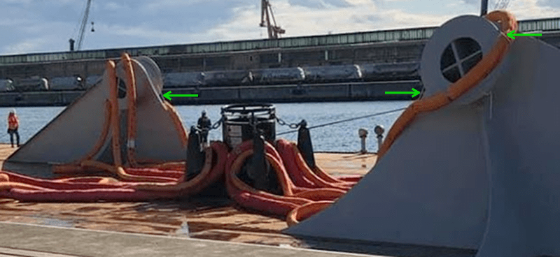

I found a better shot of the rigging. This view makes me wonder if the mooring lines slipped off the reaction bollards causing an impact load on the shaft. That could explain the clean break. You can see that the bollards are not in line with the load and that the inside ears of the bollards do not have much of a rim to prevent a large diameter line from rolling off, especially when doubled as they were.

charliealphabravo (Structural) 6 May 20 19:40 said:
... makes me wonder if the mooring lines slipped off the reaction bollards ...
It appears that the lifting points are canted longitudinally but not rotated towards the center of lift. This of course leaves all of the inside lines vulnerable to slipping off. I see some cinching cables, highlighted below,
but I struggle to understand this system.
Added: I see it now, when the hook is at the determined height, the canted planes pass through the center of lift.
