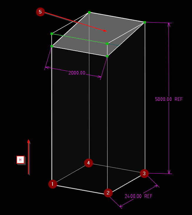

Hello,
I am looking for lifting solution , I have a steel structure of weight - 2,6 tonne that needs to be lifted by H = 650mm with MANUAL actuation , if needed cordless drill is applicable as well.
Picture below ( dimensions in mm )

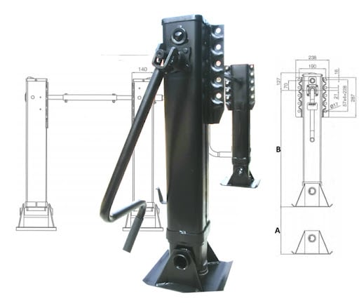

For now i have thought of landing gear jacks in each corner [1,2,3,4] however i couldn't find suitable stroke, 510mm is maximum.
After lifting of H , 2 people will be working on the top - surface ( 5 ). Surface 5 is inclined about 10 degrees horizontally. Assume that CoG is perfectly in between support 1,2,3,4 at 2000mm height.

this looks like homework ?
what does "Assume that CoG is perfectly in between support 1,2,3,4 at 2000mm height." mean ?
Will two people seriously be working on an inclined surface 5m above the ground, with no fall protection ?

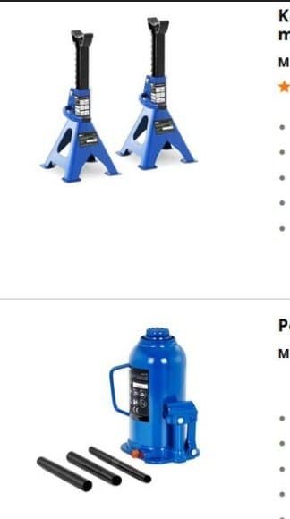

If you think 4 bottle jacks work (how will you co-ordinate them together ?) then lift 1/2 way, support structure on pads, reposition bottle jacks and repeat.
How will the bottle jacks grab hold of the sides ??
Assume that weight distrubution is equal on 4 corners, and don't worry about the people above the ground, they are protected , it is out of the scope of my question.

The idea is to connect jacks in pairs, previously with landing gears 2 jacks were connected with a shaft as can be seen on image above.
Lift has to be continuous, can't split it into lift some stroke -> stop -> support -> reposition -> lift again . I assume bottle jacks could work if they were connected to a 1 hand pump with hydraulic hoses ?

Assume that weight distribution is equal on 4 corners
That assumption is not and never will be valid with what you are considering.

I already explained how i wanted to actuate, with 2 people and 2 Jacks connected with shaft . Jacks were screwed to be fixed with the structure .I dont know about bottle Jack, that's why i asked what could be the idea for synchronizaton movements ( 1hand pump connected to 2 bottle Jacks?)
ok, the issue with the bottle jacks you can buy is not enough travel. Maybe you can get a set for 650mm travel by special order, maybe you'll have to build your own. There's only 0.65 tonne per jack, so a typical car jack would do the job.
I don't understand why the client is telling you "one continuous lift" and not two lifts with a repositioning stage in between ... it's not like the 2 stage lift would take significantly more time, if that's their concern.

Have you considered non-back drivable screw drives? Put a pulley on each screw and drive them from the same motor and belt.
I don't see a center of gravity on the sketch ...
I do not believe: "Assume that CoG is perfectly in between support 1,2,3,4 at 2000mm height."
A more accurate CG would be very simple to calculate ...

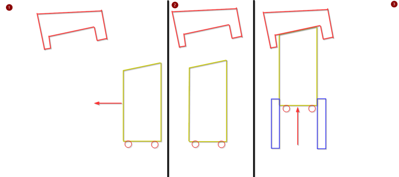

Ok additional information :
1 ) structure to be positioned under the red fixed element
2 ) structure aligned ready to be lifted
3 ) structure lifted to align with red fixed element with blue elements
It is preferred to have manual actuation for 2 people. As you can see above we have to be somewhat aligned to the red surface, but not lift it ! We don't want to get involved with pressure or amperage adjustment to secure it, we think of visual inspection with mechanism like semaphore, railway signal that when it hits the surface it rotates to show that we are aligned.
It would be great if it could be integrated in platform, not as external lifting device such as fork lift truck. I assume that at nodes 1,2,3 and 4 we need supports , maybe fixed ones to provide stability after lifting, however it doesn't necessarily mean that the lifting should be in 4 corners, i don't know this, so i am asking your opinion.

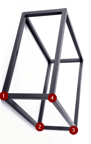

We have a frame box structure with steel profiles 100x100x5.

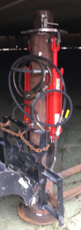

If a forklift is not possible, I might consider pipe within a pipe type supports, crossbraced for stability, both with holes for pins at various elevations, using bottle jacks or hydraulic cylinders to lift the inner pipes.

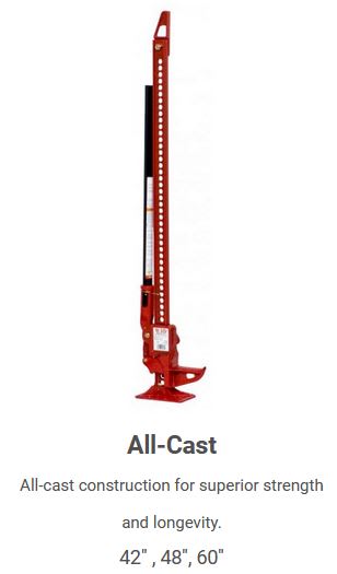

The venerable Hi-Lift jack, where every 'notch' lifted is the same lift to synchronize your manual team's effort. Rated for 4.6K lbs or 2.1 kg. More lift than you need but a controlled lift "on the count".
I would like to look at this from a different point of view. 650mm is not a lot of lift and what I'm about to propose might seem like a lot of effort for such a small lift, but it might be worth it. The main problem that I see with hoisting it from the bottom is that it might be hard to see when the two structures make contact. You could end up crushing the one structure into the other one by 10mm and your guys operating the jacks won't even notice. Hydraulic and even mechanical jacks can be quite strong. What I propose is the following: Build two towers of scaffolding, one on either side of the structure. Then you can have one guy on each tower. You attach a chain block to the red structure and then hoist the blue structure up towards it. The guys operating the chainblocks will have direct line of site of when the two structures make contact. You might even be able to use the scaffolding to aid with attaching the two structures to each other (I'm assuming you are attaching them to each other). You don't have to worry about jacks slipping or sliding or failing and in my experience chainblocks are reasonably reliable. I'm not entirely sure what kind of space you've got but maybe this can give you some food for thought.
