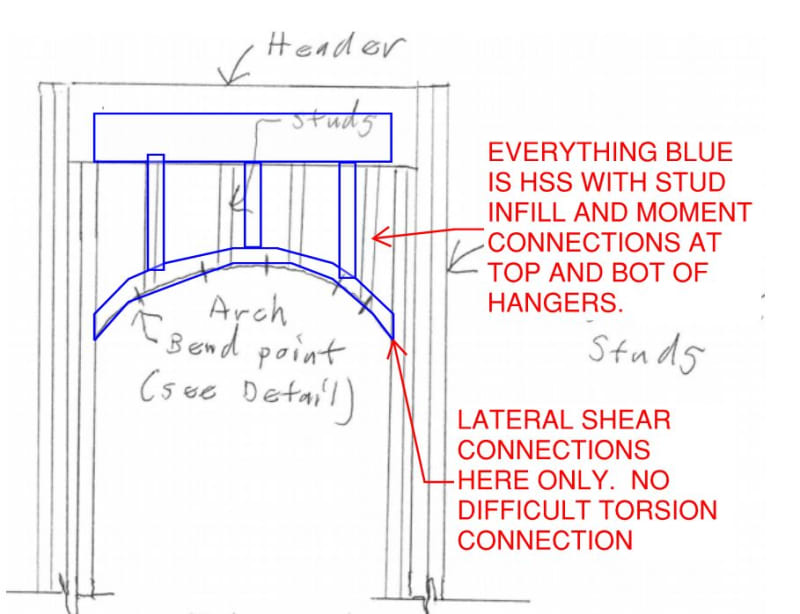

I'm somebody who has designed some light gauge/cold formed steel in my time......however, its always been straight. In observing a lot of construction over the years, I have seen situations where they used (cold formed) arches as part of the framing. This weekend I walked into a building with (load bearing) light gauge studs in progress and looked at how they did it. Attached is what I observed.
One thing I left out of my pic was the attachment of the arch ends to the the studs: just a couple of screws (flange to flange).
This left me with a few questions for anyone with experience in light gauge:
#1: What sort of calcs are necessary with this? My guess is: there are no "arch" calculations at all on the bent member (because the header is made very stiff).....and it's just a (out-of-plane) bending C-section. That brings up another problem:
#2: Any curved beams calcs for the "arch"? With the stud set up....you'd think there would be (due to out-of-plane loads).
Thanks.
 https://files.engineering.com/getfile.aspx?folder=78d30594-80e0-4977-a834-b0f6b9f71984&file=light.gauge.arch.pdf
1) My thoughts below and, mostly, as you expect.
2) CFM design is cowboy country. I've seen crazy stuff, even from engineers working on behalf of the major suppliers.
3) The flange splice detail makes me question the competence of the designer for what you saw. I feel that splicing would be ineffective and wasteful.

With your detail.....doesn't that still leave some wind load out there for the arch to handle out of plane? That unnerves me to a degree.
My thought is the header is too stiff to allow any load passing to the structures below. The arch trim may be hanging by the studs that essentially were designed as hangers.

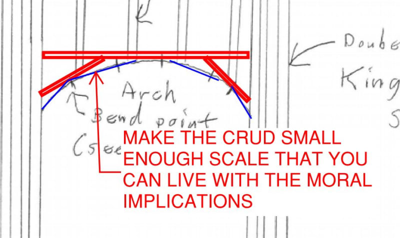

Yup & me too. The name of the game is keeping the cringe worthy bit as small a scale as possible. For things of a larger scale than you've sketched, I might:
1) Header things off with "real" framing more inticately;
2) Start thinking about rolled HSS frames for the truly large scale. The expense will raise eyebrows. Sometimes this is the only reasonable approach if your arch is large and holding up brick. In some loose homage to a proper arch, these things often support brick veneer of some strife.
At some point you just throw in the towel and go HSS everything.

Cowboy country for sure. Depending on where the ceiling is with respect to the arch, I have done propped cantilever studs off a light gage girt just above the ceiling line. This requires a connection of the backspan to the roof or floor beam. The girt is placed behind the common studs but strapped to the kings.

“The moral implications” of the fake arch - haha I love it. I have a few of them around the place where I’ve oversimplified something to make my life east and the carcass pads it out to make it look way more impressive than it actually is! Only engineers know..
Nice detail XR.

I don't wonder at all about the in-plane ability of the arch (as shown) because in-plane, it really doesn't see anything because of the stiffness of the header. It's the out-of-plane strength I wonder about. That's a (horizontally) curved beam....and for a light gauge member ....it does't take much to blow them out.
I might do some calcs later on this week (based on what I saw) and see what it could take.

When time permits, I'm going to run 2 scenarios: the original (and see what happens first).....and then with it modified as per Kootk's pic (on 6 Jul 20 21:20) and see if that little bit of wind load wrecks it.
