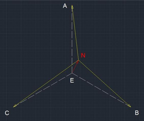

Hi all,
If we have a 3phase unbalance load (400V L-L, 230V L-N nominal voltages), which all loads are on 1phase and the other phases are unloaded, is it expected that L-E voltage in unloaded phases changes? (anything rather than 230V?)
I know that by unbalance loading, neutral point displaces and neutral voltage is something rather than 0. Therefore I expect L-N voltage changes on all phases. But my question is about line to earth voltage.
I ask this question because software simulation of such unbalanced load by DIgSILENT power factory shows such strange results!
With an unbalanced load you will get a voltage drop on the loaded feeder conductor ans possibly the supply transformer. This may be significant.
With an unbalanced load you will also get a voltage drop on the neutral feeder. This may be significant. Additionally the neutral drop may have lessor ampacity than the line conductors.
Now, starting with an equal sided and equal angle star diagram and considering "A" phase to be the loaded phase,
The voltage drop on the neutral will be towards line "A" or "A" phase.
The voltage drop on the "A" phase feeder will be towards the neutral.
Now draw a triangle using the new position of "A".
The line to line angles are no longer 120 degrees.
Now using the new position of the neutral, draw a star diagram from the neutral to "A", "B", and "C".
The line to neutral angles are no longer displaced 120 degrees and while the voltage has dropped on "A"to neutra, you can see that it has raised slightly on "B"to neutral And "C" to neutral.

Let's say we have a 2500 kVA 3*400 V 6% short-circuit voltage grounded Y connected.
The copper losses 9000 W. Calculated Z=0.4^2/2.5*6%=3.8E-3 ohm[3.8mΩ]. In=2500/sqrt(3)/0.4=3.608E3 A [3.6084 kA]
R=9000/3/3608.4^2=2.3E-4 [0.23 mΩ]
X=SQRT(3.6084^2-0.23^2)=3.601 mΩ
A supply cable of 4*6 mm^2 copper XLPE insulated PVC jacketed of 100 m up to our main panel. x=0.144 ohm/km r=3 ohm/km Zcbl=sqrt(0.0144^2+0.3^2)=0.30035 ohm; Ycbl=Yo=1/0.30035=3.329
zcbl=0.3+j0.0144 ohm; Ycbl=3.326-j0.16 siemens
Let's say we have a single phase [phase R and N] 400/√3=231V loaded with 10 kW and cos(ϕ)=0.85.
Sload=10/.85=11.77 kVA; Iload=11.77/0.231=50.95 A [rated]
If the load is constant, we may calculate Zload=0.231^2/0.01177=4.5336 ohm YR=1/4.5336=0.220257 S
Actually ZRload=3.85+j2.388 ohm YR=0.1875-j0.1162 S[Siemens]
At main 3 phase terminals we have -almost-a unchangeable voltage of 400/sqrt(3)=231 V
Then we can neglect transformer impedance and cable impedance but we keep the neutral wire impedance in calculation.
From here we have a lot of way to continue calculation like Millman theorem, Kirchhoff and other. You may use absolute values or complex. Whatever the difference is less than 1%.
Using Millman theorem:
Vn[the voltage between the neutral at our main and the transformer neutral]
Vn= [VR*YR+VS*YS+VT*YT]/(YR+YS+YT+YLoad)
If YS=YT=0 then Vn=VR*YR/(YR+Yo)=14.35 V
Using complex numbers Vn=12.85-j6.63
Now Van=Va-Vn=231-14.35=216.65V
Using complex numbers Van=218.25V
Vbn=232 V
Vcn=243V
If we shall take Zo=∞ then Van=0.361431;Vbn=399.6;Vcn=399.8 V

Hi all,
thank you for your answers. I think you got my question but your replies do not answer my question.
First to make assumptions more clear: neutral point at load is not earthed. It is abviously clear that by an earthed neutral on load star point we would have a voltage drop on phase A (loaded phase) and nothing more (no change in neutral or other phases voltages).
The question is about phase to earth voltage of unloaded phases, when neutral is not earthed at load terminals and load is just on phase A.
In this case, I expect that a voltage drop occurs on phase A (Va<230), voltage on neautral point raises (Vn>0), phase to neutral voltage on phase A reduce (Van<230) and phase to neutral voltage on unloaded phases increase (Vbn>230 and Vcn>230 because of displacement in neutral voltage point). But I don't expect any change in Vb and Vc! (should be: Vb=Vc=230) However, DIgSILENT shows change in Vb and Vc! and important point: this is because of cable. It means when I use a 3core cable, the results are so that I expect, but when I use 5 core cable, these strage results come out.
I have read your answers carefully. But I think when Bill talks about drawing a triangle, he assumes Vb and Vc are on the same place (as I am) and when 7anoter4 calculates Vbn and Vcn, he also assumes Vb and Vc are 230V.
From what I can understand, OP is asking a very teorethical question and che12345 is correct with his answer (but without any context, all the answers here are valid at some point):
I think he is referring to the fact that in an ungrounded star system with an unbalanced 3 phase load, the neutral voltage (N in figure below) shifts from the theoretical earth potencial (E). This usually obtained with the symmetrical components method for solving unbalanced 3 phase systems.
For the case mentioned by OP: all loads on 1 single phase, and the other 2 unloaded, there is no such phenomenon (in the symmetrical components kind of way) and the only neutral voltage displacement would be the one produced by the voltage drop on the neutral conductor as waross mentioned and 7anoter4 showed by example. This could be more or less noticeable depending on the neutral ground connection (far from the load-> more noticeable / close to the load -> less noticeable).
And to answer OP specific question: There will be no change of voltage on the unloaded phases with respect to earth E as che12345 already said, but it will with respect to neutral N as waross and 7anoter4 said.
