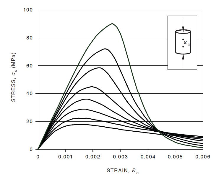

This family of curves is from the commentary to the Australian concrete code.
It seems that your assumption of linear behavior up to 0.001 is generally fine except for lower strength concrete mixes.

There have been some good responses there and I've found a few more in other resources I own. I think I'm pretty comfortable that linear strain is valid to ~0.0015 for typical concretes and gets better for higher strength concretes.
Certainly, accurate enough for the kind of job I'm trying to do here
