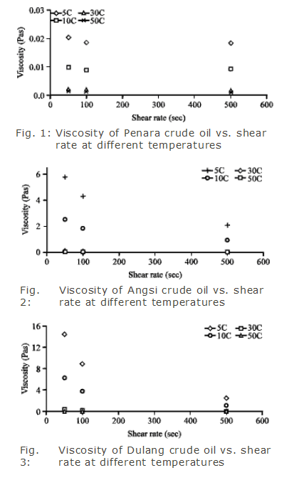

They should have some graphs for their wax that look more or less like these,
Theose are plots of 3 SE Asian waxy crude oils.

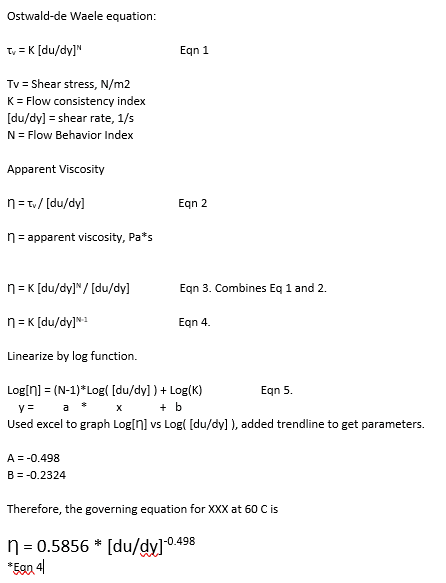

The problem with using the client's data is that unless you also hit the exact same flow rate, pipe diameter, and temperature, you won't replicate their viscosity. You need the data for viscosity vs shear rate at their given temperature. You can follow the following steps to get the standard parameters for shear-thinning liquids. The below steps are what I used in the past to get the viscosity parameters. This should give you what you need to ultimately determine pressure drop at a given flow, temperature, and pipe size.
Below is an example calculation I did on a shear-thinning polymer from viscosity vs shear rate data from a rheometer.
