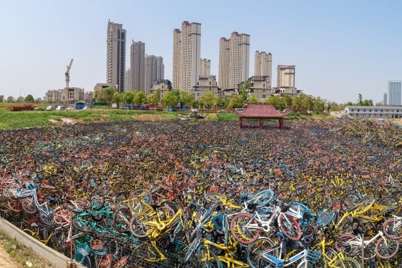

Back to the old-stuff storage - an area that should be of great concern is that electric bikes and scooters and so forth tend to get accumulated by humans thinking they can refurbish, repair, strip and sell parts, or are just obligated to collect fleets that landfills won't accept. There might end up a warehouse with 10,000 of those rental scooters owned by a company that has gone bankrupt.
Imagine this, but with batteries:
