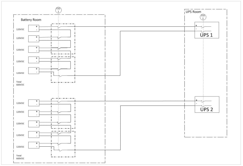

I ended up using an N+1 (in this case N=1) redundant UPS with one common bypass, two supply feeders, two rectifiers, two inverters, two battery banks each with their own cables and DC breakers with shunt trip and one common output side bus. During the normal operation each will have 50% of the load. In case one set fails the other will take over 100% of the load. At any time each one of the UPS can be isolated and worked on (with work procedure and LOTO of course).

Hi Keith & Scott,
Here is a sketch I made for you:
I did not sketch the full UPS side as it is a standard N+1 topology as I explained in my previous post. If we loose independent side e.g. a battery string, say faulty cell, or one inverter, etc. the other UPS will still provide the supply, albeit with reduced autonomy time.
From the charging profile, the UPS will pick if the battery is faulty. The circuit breaker in the battery room will also provide some protection against a short circuit of part of the string to chassis. Also it breaks the string into 120V segments which makes it easier in certain fault cases also makes working on batteries easier.
Cheers,
Hammet
