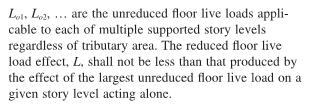

It is similar which is why I tabled it. The snippet below, applicable to one and two family dwellings, conveys a similar sentiment I believe.
Interesting, what is that snipped from as I don't recognize it.
That's actually the tail end of ASCE 7-10 4.7.2.
That section was removed in the errata for the 2nd printing. With that said I think it shows what they were thinking for reduced live load on multiple floors.
