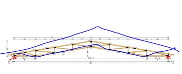

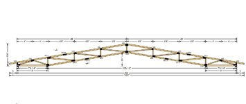

Attached is a picture of the truss. The bearings are aligned with the walls of the seacans. From my understanding, people put a 2x plate along the top of the walls. This is a much larger span than what we normally design so in this case there is a large 1000lb+ uplift (with 24"oc) on the outside wall.

That's pretty big. Not sure a 60mm square tube, especially 40 ft long, is going to like that.
You might need to start thinking about reinforcing it with some vertical posts inside I r outside the container.
Here it is for others.
I'd be careful putting the load down on both walls of the can... maybe have a support between the walls.
I've attempted something similar and, in my opinion, it really cannot be made to work by the book.
As far as downward load goes, your 2x plate(s) will be completely ineffective as far as load distribution goes. That, because their stiffness will be dwarfed by that of the side walls.
And the same will hold true of the container top rail really. I believe that the top rail's job is really just to deliver uniform roof loads to the side walls without introducing too much localized for or eccentricity. As others have said, the only structural members of significance in these things are the corner posts. And, to a lesser extent, the beams at the front and back of the containers.
Where your trusses touch down, there will be a point load on the corrugated side wall. Your failure mode will be local buckling of the corrugated side wall. If you double the spacing of the trusses, that point load will double +/-. If the trusses are close enough you'll get some benefit from overlapping side wall buckling patterns but that will be very difficult to account for.

I would be inclined to design your trusses to not utilize the exterior bearings. Those will be difficult to hold down and will amplify the load at the interior bearings.
I imagine the truss company is trying to use that couple to make the trusses more efficient. I would be curious how much heavier they get with only the inside bearing.

Maybe. Often these things are in such locations that depth is almost a non-issue. @Zoobie777: what say you?
One also has to weight the cost of sturdier truss against the cost of the hold down situation.
I suppose another thing to watch is to make sure the thrust at the truss bearings doesn't just push the seacans over.
